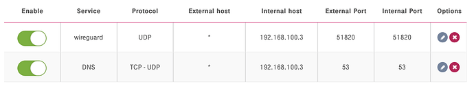

So what kind of port forwarding did you set?
beside that I’ve put the internal IP of the brume router in the DMZ of the main router/modem, I’ve set the 51820 as port fwd in the main router for brume’s IP.

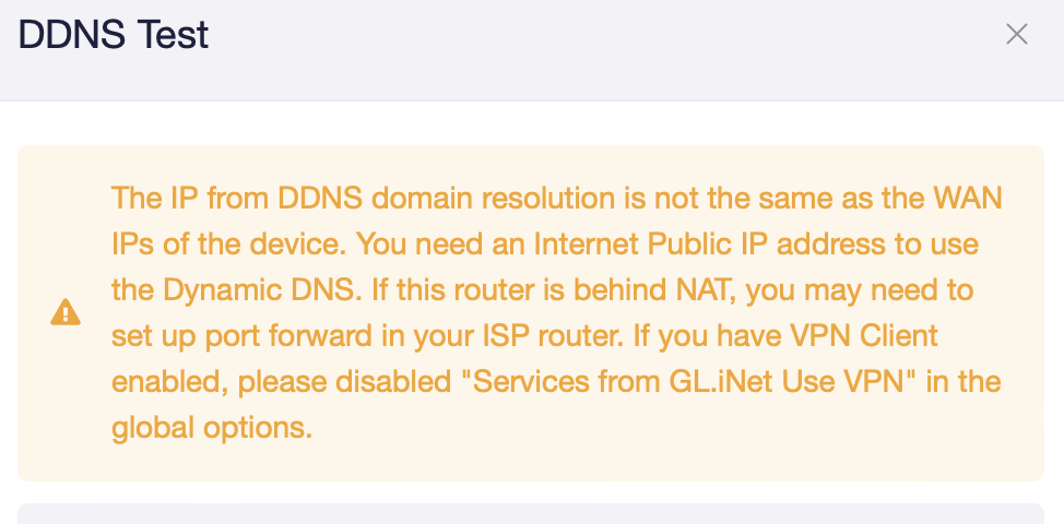

However, on the brume, I still get this message when testing the DDNS:
Anything else should I check? What else can be wrong? Anyone any idea?..

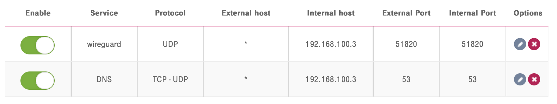

Not yet, but you should disable the port forwarding for DNS (UDP 53)
It’s not necessary and a problem speaking of security.
I’ve removed that DNS UDP 53 port fwd rule, thank you!
