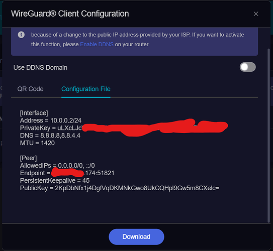

Below is the config for wireguard
I'm using port 51821 and when I check to see if its open from port checker, it says its closed.
I have remote access LAN selected in the wireguard settings.
Any ideas on how I can troubleshoot this and get remote access to my LAN via wireguard? I had tried tailscale as well to see if something else was causing but that worked without issue, but I would rather use the Wireguard server on the router. Thank you in advance for your help!
I see you use in the peer section not the ddns one but a direct ip as endpoint.

You can't check WireGuard like this, you can only check by establishing a connection, not by any port testers.
