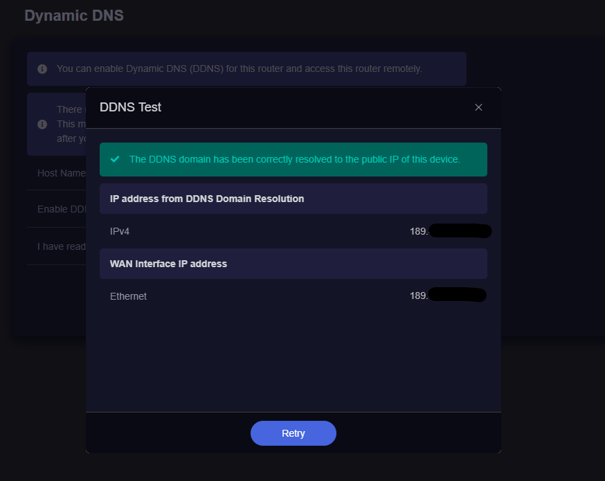

I'm using the Wireguard client for a private VPN from Proton and I wanted to activate the Wireguard server to access my internal network, I activated the GL DDNS and confirmed that it is working and then I activated the Wireguard server and created a profile but I can't access it because the wireguard transfer log is at rx:0
I already checked on the firewall that port 51820 is open.
