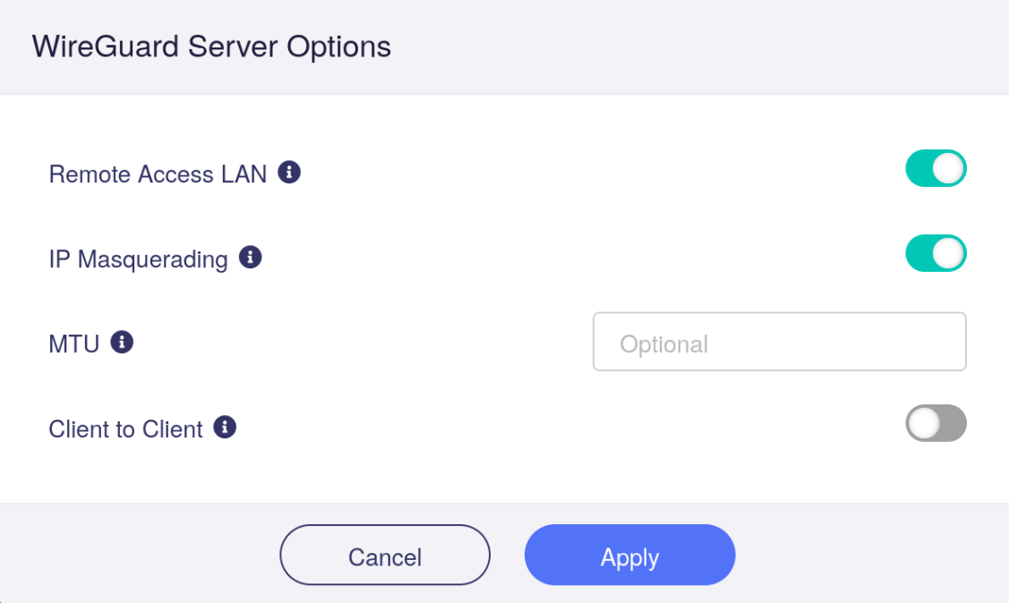

I changed the port of wireguard server from 51820 to 53, and was able to reach the router from a remote client. However the remote client did not get access to internet, it seems the router stopped NATting the traffic out to the internet i.e. remote client couldnt ping to 8.8.8.8 but could ping 192.168.8.1
I do have IP masquerading enabled,
