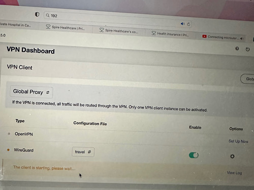

I’m trying to set up both server and client on 2 different Beryl AX. Something is not going right. I am not super good at this and read the docs and forums and watched YouTube. But I really need this to work soon and can’t figure out what is wrong. I have Xfinity for internet and set up a port forwarding. Can you tell what is wrong from the screenshots?

Yes, still having trouble thank you. It says since I’m a new user I can only put one image but trying here for the others. Sorry they aren’t the best, I probably need to paste the actual log and can do that when I’m back on it in a bit.

REKEY-GIVEUP indicated that you can’t reach the port of the wireguard server you are connecting to.
Is the wg server behind CGNAT maybe? (What is the external IP of the router which acts like a server, according to the GUI?)

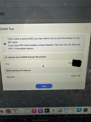

Is this the Xfinity router or the Beryl I set up as a server? This image is from Xfinity settings. I’m not sure where to look in the WG GUI to find the external IP.
IMG_2024-03-14-140555
Wondering if it has to do with this?
IMG_2024-03-14-145912
It looks to me like the Xfinity modem is in router mode.
So in the Xfinity router admin menu you can try to enable port forward for UDP 51820 to the private ip address assigned to your gl.inet router, which looks to be 10.0.0.171.
Also you might check the WireGuard Client config file (it is a plain text file) that the server IP address matches the public ip assigned to your Xfinity modem.
Alternative is to change the Xfinity modem to bridge mode, if you are not also using xFi wifi as your wifi. In bridge mode, the glinet router will be assigned the external IP address currently assigned to your Xfinity modem.
Eventually you may want to try to enable glddns and use the GL dynamic dns name instead of the server IP, in case Xfinity ever changes your public IP address.

Thanks for posting this info. I wonder if the problem might be that the Xfinity modem is using the 10.0.0.x subnet, and the Beryl Wireguard server appears to be using the same subnet for the Wireguard assigned IP addresses. You might try to reconfigure the Wireguard server and generate a new client config also. See step 2 in the gl.inet Wireguard server tutorial:
The default configuration works for most cases. If you found the IPv4 address conflict with your upper router’s gateway, click the Apply button after modification. You can modify it as 10.1.0.1/24 , please don’t forget to put /24 at the end, otherwise you clients cannot get connections.
It was so simple I feel really stupid. I followed your advise and still couldn’t connect. So then I was reading how it can’t be on same network when trying. So I connected the client to my phone hotspot and it worked!!! Thank you for all the help.
Glad it’s working now. Yes, wireguard listens on the WAN port and testing with an external device is the only way to know for sure that the config will work when you are away from home. With your Xfinity modem, the port forwarding and changing the wireguard subnet are necessary.
