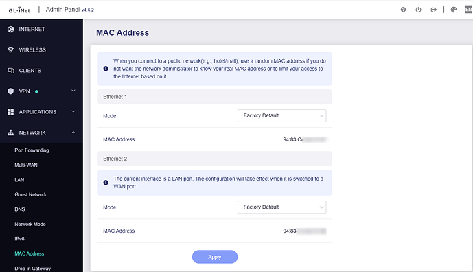

The MAC for WAN (wired), please find it in: GL GUI -> Network ->MAC address
Wireless WAN MAC addresses can only be found by SSHing into the router.
