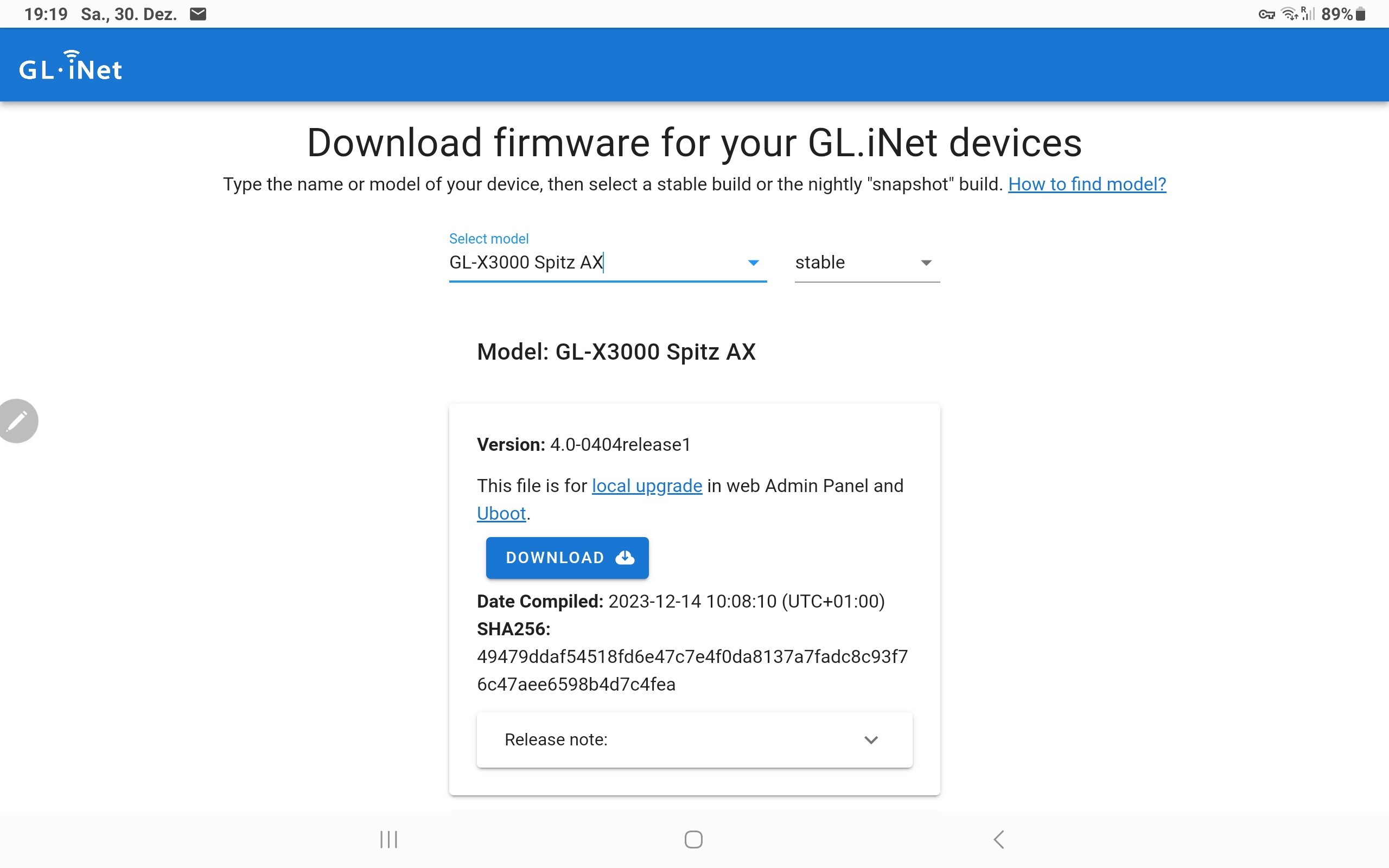

The firmware ist the newest one!

Can you download and test the beta firmware ?

Beta and Stable is the same…

Although the beta looks the same as the stable one, I installed it yesterday and the modem has been keeping the connection since then, let’s see how long…
