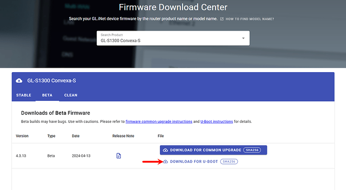

Please follow the tutorial to flash the GL firmware in uboot:
If no luck, please screenshot the uboot UI.

I've just tried the 72MB beta image you reference above and while it appears to upload and reboot etc. It gets an IP address of 192.168.1.160 (same as when it was a mesh device) but no GUI - ie exactly the same result as before.
Is there a way to truly restore back to factory conditions including passwords etc ? Maybe I need to use TFTP or similar as clearly uboot isn’t working for me.

Saw your background, you did not need to uboot to flash firmware, just restore the factory settings by long pressing the reset button and then brand-new setup.
