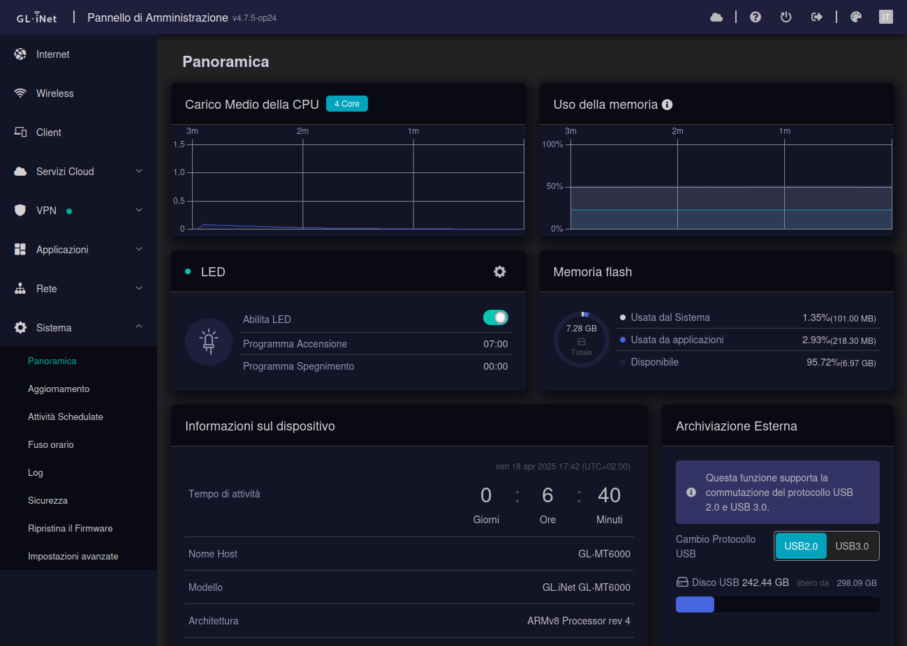

Upgrading from 4.7.0-op24 to 4.7.5-op24 I noticed a lower ram usage, maybe in your case it can help, staying with an obsolete version like 4.6.6 doesn't make sense in my opinion.
okay how was my router crash after update long blocking list Ad-guard. Now is just are stable not crash after update and the ram are more free ?
I have never had crashes or other problems even with 4.7.0-op24, simply now with 4.7.5-op24 it uses less ram with the same settings and conditions, I use adguard but I don't have all the lists you have active, I only have 6, exactly like before, but before the ram use reached about 370 MB, now it doesn't exceed about 280 MB.
I should just see if it remains stable over time and doesn't increase much, but so far everything is ok.
It's really using less or it's just reporting less?
I saw this thing a while ago too, but I'm sticking to what the GL GUI shows
