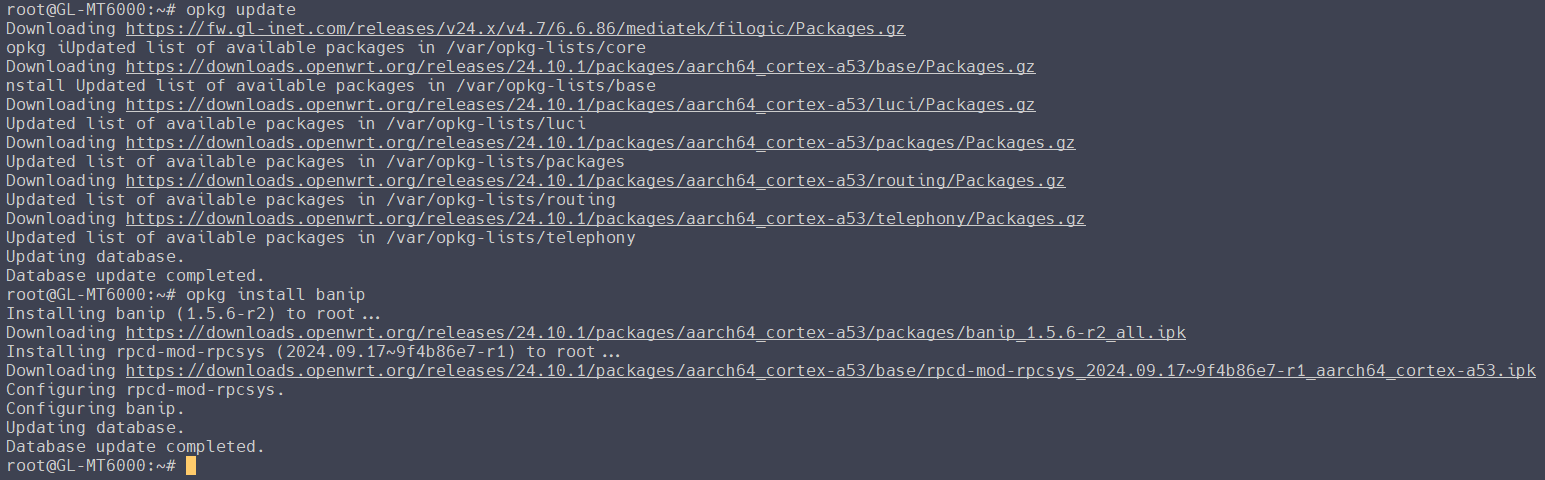

I wanted to install banip... but I get an error:
root@GL-MT6000:~# opkg update && opkg install banip
Downloading https://fw.gl-inet.com/releases/v24.x/v4.7/6.6.86/mediatek/filogic/Packages.gz
Updated list of available packages in /var/opkg-lists/core
Downloading https://downloads.openwrt.org/releases/24.10.1/packages/aarch64_cortex-a53/base/Packages.gz
Updated list of available packages in /var/opkg-lists/base
Downloading https://downloads.openwrt.org/releases/24.10.1/packages/aarch64_cortex-a53/luci/Packages.gz
Updated list of available packages in /var/opkg-lists/luci
Downloading https://downloads.openwrt.org/releases/24.10.1/packages/aarch64_cortex-a53/packages/Packages.gz
Updated list of available packages in /var/opkg-lists/packages
Downloading https://downloads.openwrt.org/releases/24.10.1/packages/aarch64_cortex-a53/routing/Packages.gz
Updated list of available packages in /var/opkg-lists/routing
Downloading https://downloads.openwrt.org/releases/24.10.1/packages/aarch64_cortex-a53/telephony/Packages.gz
Updated list of available packages in /var/opkg-lists/telephony
Updating database.
Database update completed.
Installing banip (1.5.6-r2) to root...
Downloading https://downloads.openwrt.org/releases/24.10.1/packages/aarch64_cortex-a53/packages/banip_1.5.6-r2_all.ipk
Collected errors:
 * opkg_install_pkg: Checksum or size mismatch for package banip. Either the opkg or the package index are corrupt. Try 'opkg update'.
 * opkg_install_cmd: Cannot install package banip.
I do several opkg update and I always get this error.
Is this normal?
Can it be fixed if not?

It seems that one dependency package is missing. Please try again.
I can confirm
Thanks, it works fine now.

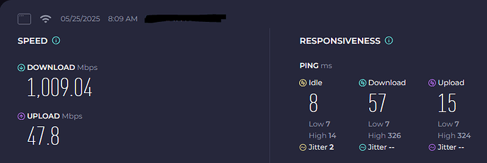

I'd like to share my current upload and download speed results. The MT-6000 has received another performance boost with OpenWRT 24.10.1, and I’m genuinely impressed by this device’s performance. Wi-Fi is completely disabled, and there is an active WireGuard connection to a VPN server in Frankfurt am Main. All devices are connected via the 2.5 Gbit LAN port.
So far, I’ve never managed to exceed 1000 Mbps download speed on any other router — until now. My current maximum download speed is 1140 Mbps, and my upload speed peaks at 55 Mbps. I'm curious to see what the successor to the MT-6000 will be capable of in this regard.
@bruce: KUDOS to the developers of the latest OP24 firmware release for the MT6000!

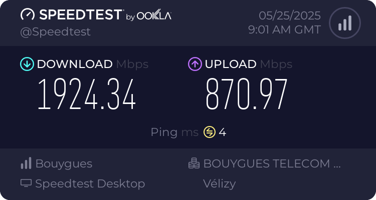

I just did some speedtest, with ethernet cable, and they are very good form my internet connection.
My ISP gives me 2000 DL / 900 UP, and yere a speedtest done several minutes ago:
I'm not connected through a VPN provider.
I'm not sure I did a speedtest with 4.7.5 op21 to compare...
OT: the ISP speed is interesting, since DL bandwidth is far less then UL. :slight_smile:
