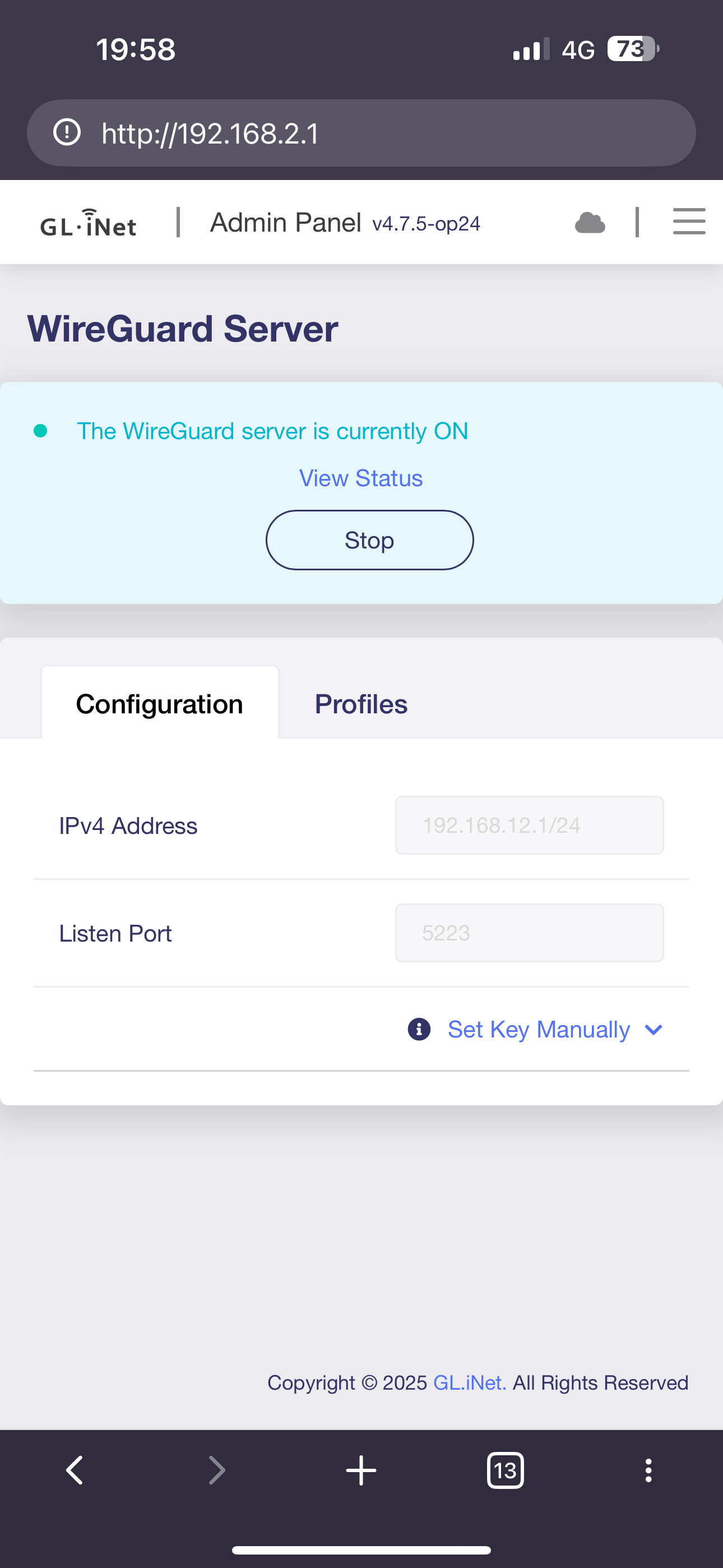

WireGuard Server on the Flint2 GL-MT6000
Port used : 5223
The WireGuard Server in the flint2 gave me an address in the range: 192.168.12.2 to 192.168.12.xxx.
My iPhone has 192.168.12.2/24
My Mac has 192.168.12.3/24
Here the configuration I have :slight_smile:

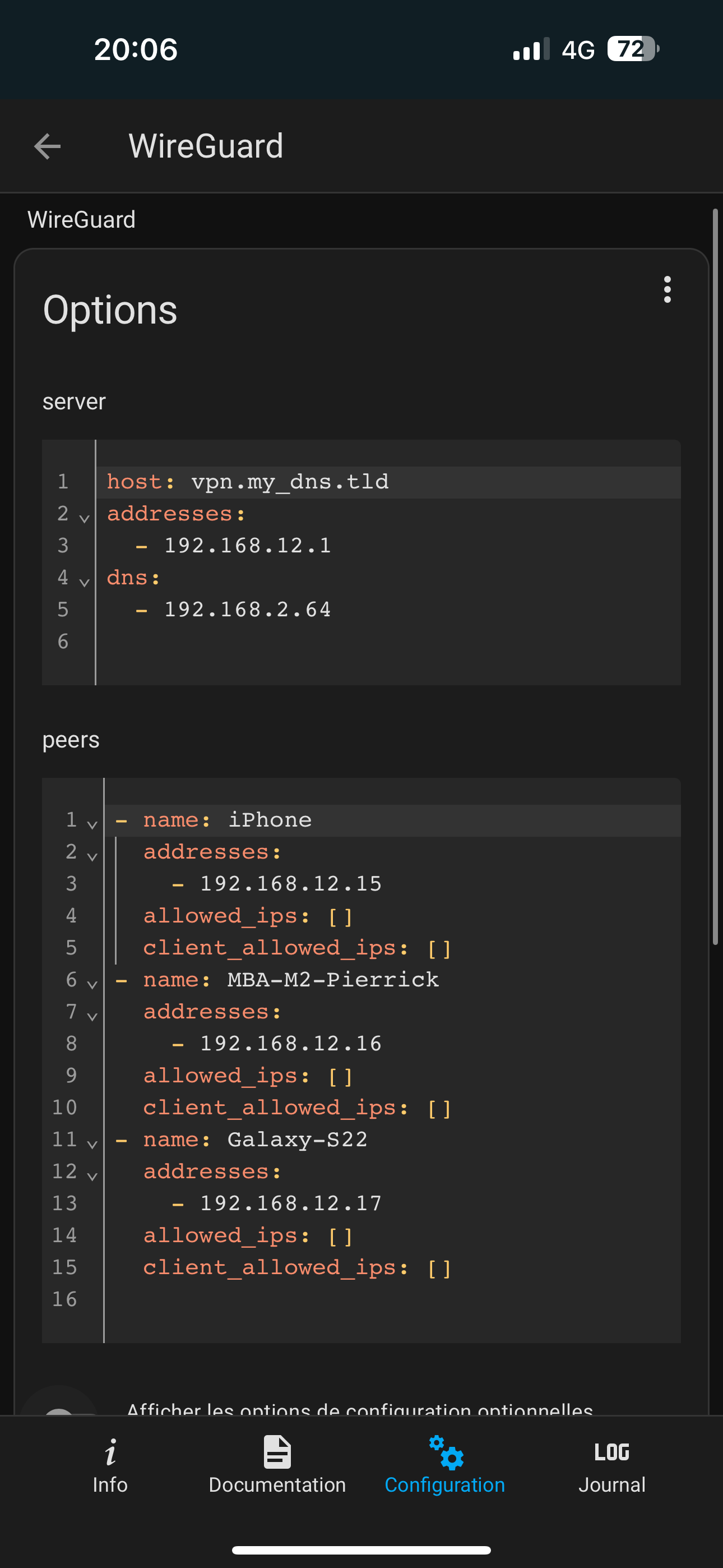

The WireGuard server on my HAOS VM
Port used : 51620
Configuration:
I don’t know the mechanics under the hood for both servers but I can access from both connexion all my ip lan , except the Asustor’s one only if I’m connected to the Flint2 WG server .

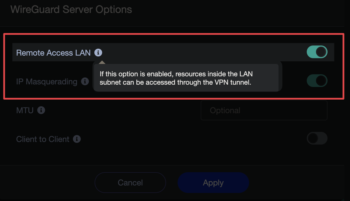

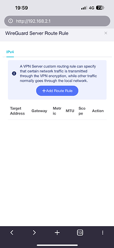

1)I wouldn't have both VPN servers allocating ip's in the same range. They should be treated as seperate networks.

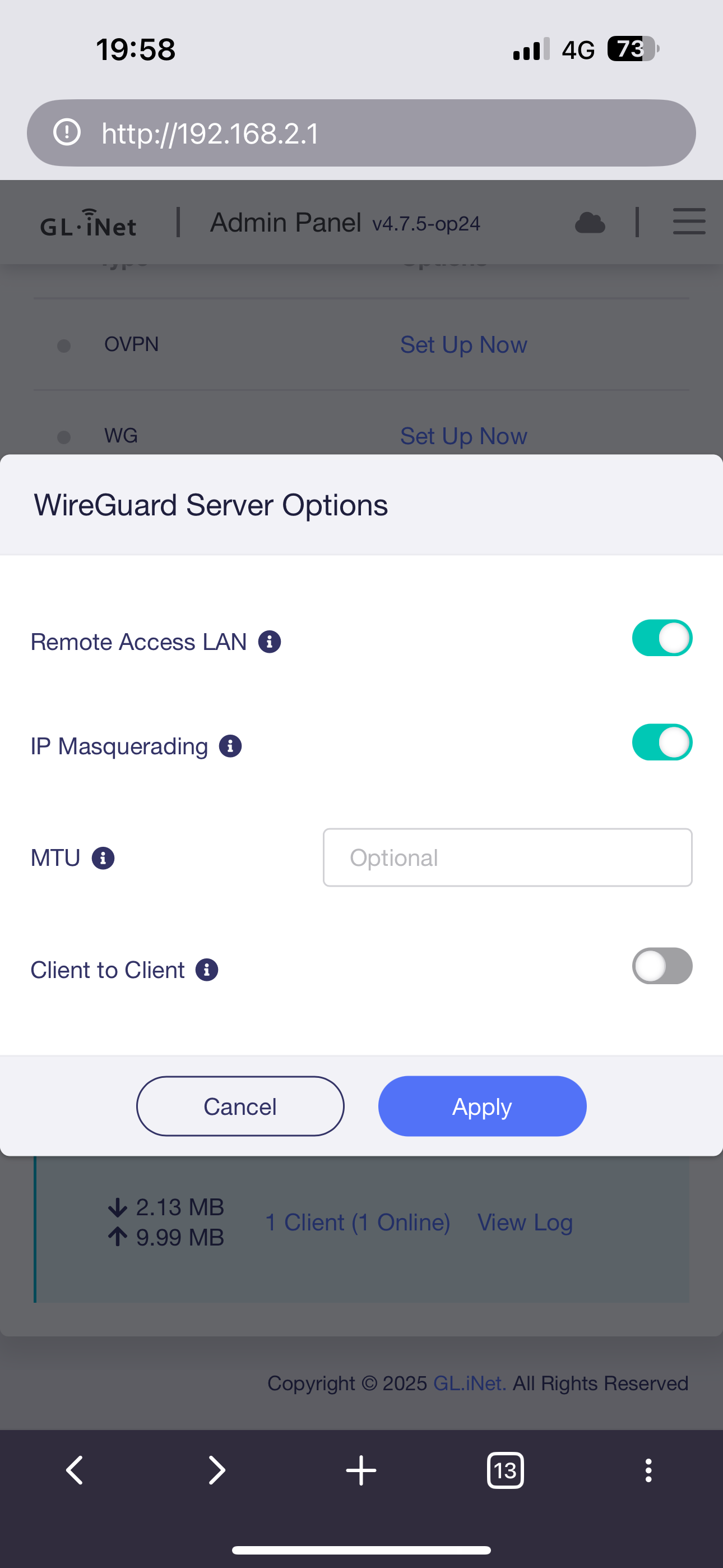

2)I wouldn't be using masquerading for the VPN clients to access my internal Lan. I assume masquerading on both your VPN servers is what is making things work as much as they do. But also breaking other things. IMHO masquerading is intended for VPN clients trying to bounce back out the wan and not for accessing the Lan. Masqueraded internal ip's likely fall under unsupported for all kinds of software.
3)The haos is unfamiliar to me but the VPN config seems incomplete lacking allowedips etc. but perhaps blank leads to auto filled data?

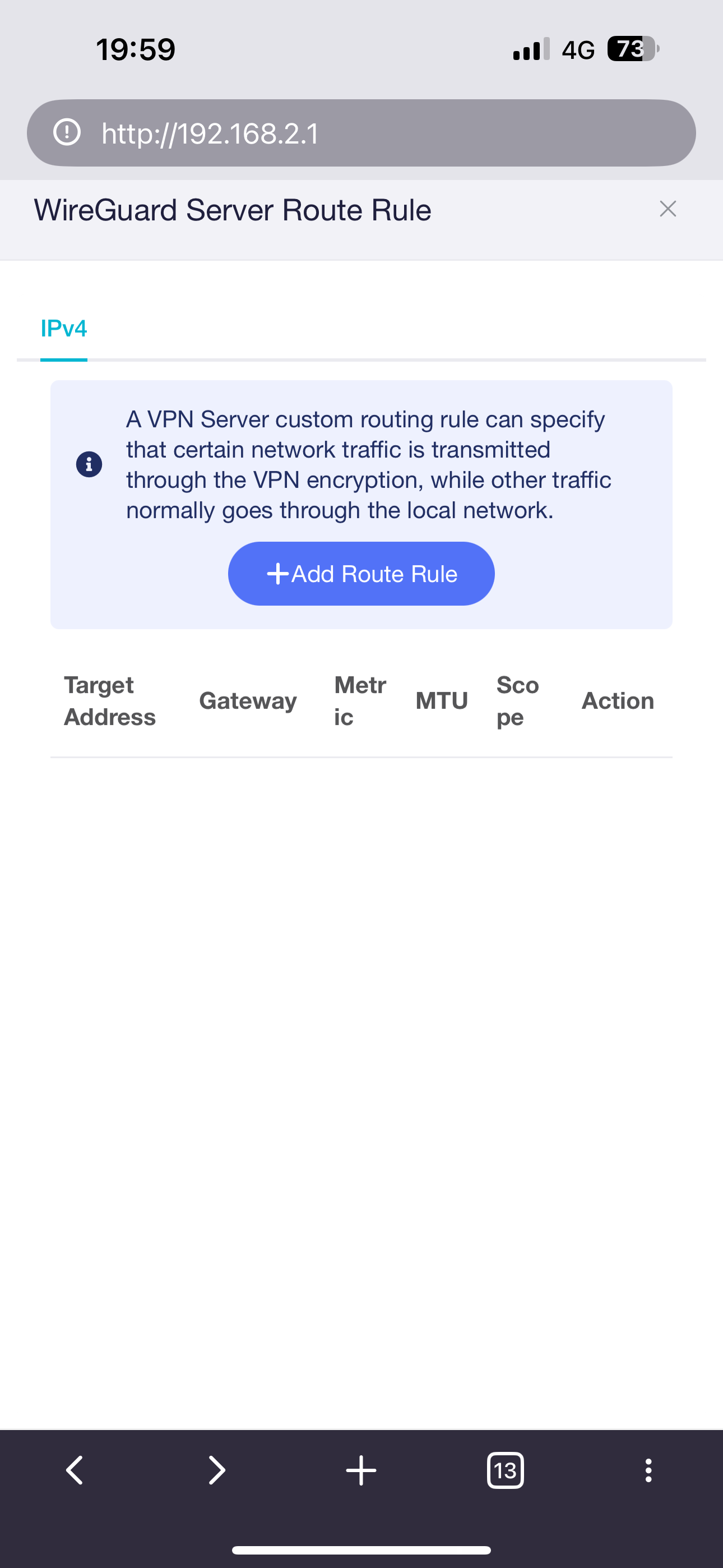

4)I would add a static route to both VPN servers for the other VPN server's client range to reach their correct gateway. In particular the default gateway in the main lan network should have the static route to the other VPN server.
5)recheck the asustor network config, reboot it, check routing table if possible etc.

That is the issue. I attempted to change the subnet to 192.168.10.1/24, and everything worked fine afterward. However, I am uncertain about what happens when it fails only for one specific LAN IP address.

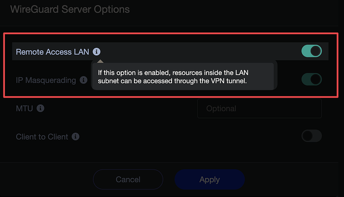

I am having difficulty understanding the explanation of IP masquerading. My primary goal is to access my local area network (LAN) through the VPN WireGuard server without being identified by the internet IP address associated with my iPhone.

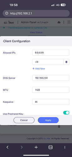

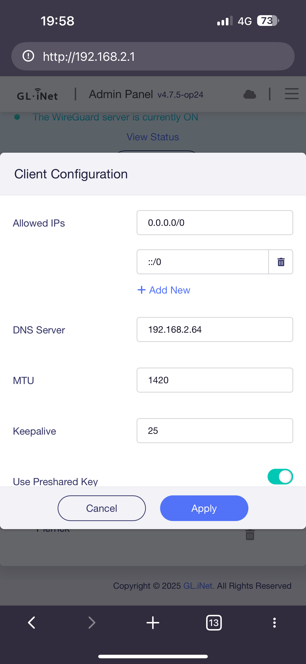

The allowedip parameter is set to 0.0.0.0/0 by default, including the same configuration for IPv6, which I have removed.

The only solution that works is changing the subnet of the WireGuard server.

IP masquerading will replace that tunnel IP address with the IP of the interface it wants to masquerade as, eg the wan interface IP. But masquerading could potentially use the lan interface ip and become 192.168.2.1 if the software was confiugured to do so. Eg the asustor would see 192.168.2.1 connecting. The asustor can directly reply to 192.168.2.1 because it is within its own subnet, as a silly coincidence this device is also its default gateway which it would have sent the data to anyway if the ip was outside of its subnet.
This is potentially how you can connect to the haos and still access the lan even though you have no return path for the vpn clients tunnel address. The asustor can direct reply to 192.168.2.140 and the haos uses its nat table to find the wireguard tunnel that made the request.
Masquerading could cause different ports to be used which could break things that do not tolerate different ports to be used.
Also session data within the ip packet could include the IP address of the client. Many apps can tolerate a wan ip header and lan session ip as this is a common problem but might fall over if you have lan ip header and a different lan session ip as this would be an unusual state.
If 192.168.12.16 was connected to the haos and the haos didnt use IP masquerading the asustor would not be able to direct talk to 192.168.12.16 as it is outside of its subnet and would would send the data to its default gateway(the gl-inet). The Gl-inet will not know where 192.168.12.16 is either so gets to use a bogan filter to dump the data or route it upstream to its default gateway, aka your ISP, that would likely use a bogan filter to dump the data. A static route in the gl-inet could tell it the 192.168.12.0/24 destined data should be sent to the haos.

Changing the subnet for the GL-iNet WireGuard server resolved the issue I was experiencing. I suspect that the Asustor may have, in some way, blacklisted something. However, the reset I performed restored the network settings and disabled the ADM Defender, which includes the firewall and blacklist. Nevertheless, I am uncertain because I created some profiles for the GL-iNet WireGuard server to obtain the same IP address provided by my backup WireGuard server (the one on the HomeAssistant server). Despite being able to connect to the GL-iNet WireGuard server using the same IP as HA WireGuard server, I still cannot access the Asustor LAN IP.
Thank you for the explanations; it is somewhat clearer to me now. I have just deactivated the masquerading option (I tested my VPN connection to check for any issues, but I did not encounter anything unusual).
