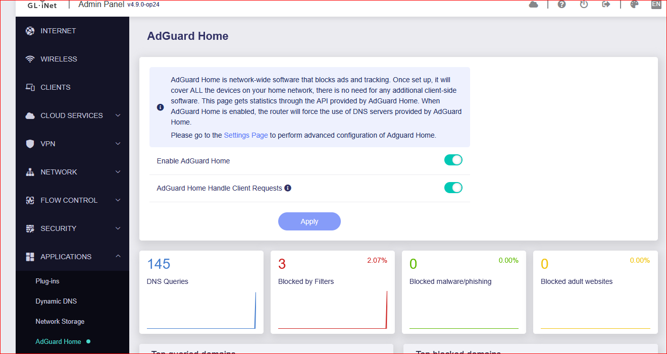

I was able to update AdGuardHome to version 0.176 via the console. In firmware 4.9.0, the client handling counter is still displayed correctly and appears to be working as expected.
@bruce I found a DNS leak issue in this firmware. When the VPN is enabled and AdGuard Home is running, DNS requests appear to leak through the AdGuard Home DNS IP instead of being fully routed via the VPN DNS. If needed, I can provide log files for further investigation.

If ADG is enabled, DNS resolution will use the DNS servers configured in ADG. This shouldn't be considered a leak, that is an expected behavior.
If there is a policy in the VPN tunnel and it is configured with a 'Specified Domain' list, you can enable ADG, but cannot enable 'AdGuard Home Handle Client Requests' option.
If the behavior you are experiencing does not match this expectation, please PM me the syslog, we try to check first if there is indeed an issue.

Hi Bruce,
this can’t be correct. When I configure specific devices to use the VPN, as shown in the screenshots, those devices should also use the DNS server configured in the Wireguard config.
With this new default behavior, DNS requests are no longer routed through the VPN, which results in DNS leaks. To prevent this, I would need to use a separate router or implement additional network configurations.
On firmware OP24 4.7.7, this setup worked as expected and did not cause any DNS leakage. Could you please clarify whether this change is intentional or if it is a bug?
