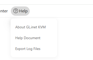

If it still doesn't work, please export a log to me through the KVM help menu after entering BIOS

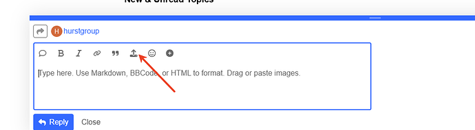

How do I send an attached file?

  • I did not see the upload icon so my fault

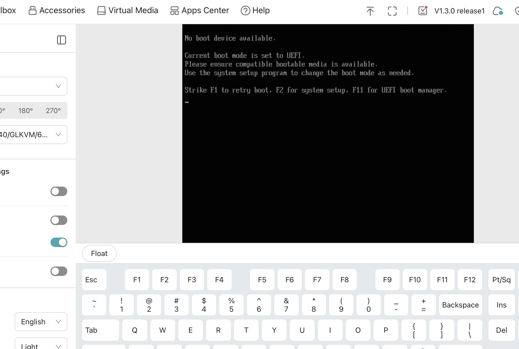

Now the current issue we have is that we cannot press the function keys to be able to enter setup. The attached screen shows progress so far. Can you advise. THis is on a Mac.
UPDATE: I have just updated the Mac App and also the KVM itself to the latest versions but still no joy in pressing the keys.

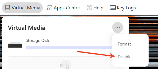

disable msd , many old bios refuse a usb composite device contain both hid(keyboard and mouse) and msd(cd-rom/ thumbdrive)
