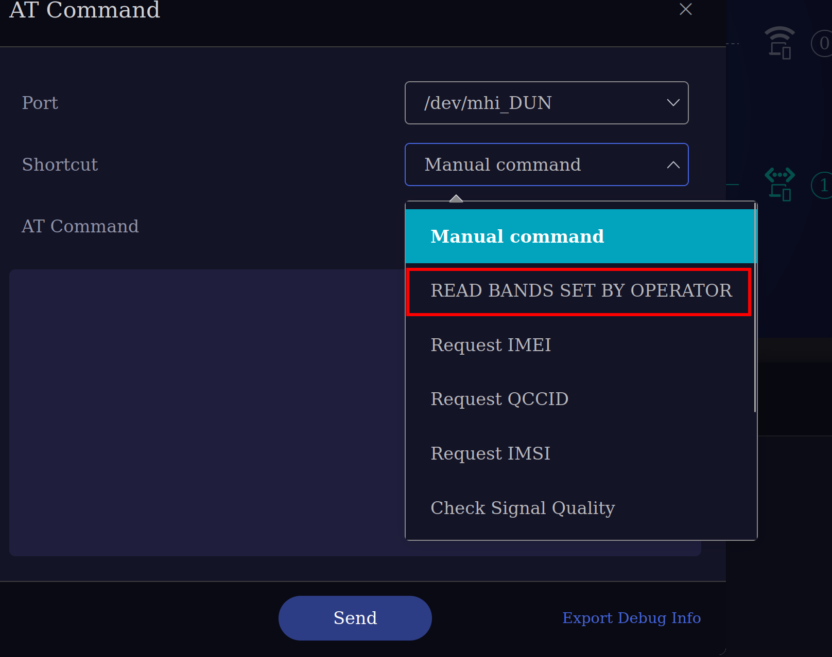

    • As you can see, this is the original defined list:
  1. Define a custom item list using the following format:
    {label:“any label”,value:“the command you want to execute”}
  • For example, let’s say I want to read all bands set by my operator:
    {label:“READ ALL BANDS SET BY OPERATOR”,value:‘AT+QNWPREFCFG=“policy_band”’}
  • In vi to insert into the open file, you need to hit i (means insert mode). Once you finish editing the file, hit Esc then input :wq and hit Enter. So, inserting my defined list’s item into the list right after the “Manual command” would look like:
    Note! I replaced the double quotes with single quotes since my command itself include double quotes; otherwise it will not work! If your custom command does not include a double quotes, then no need to replace it as I did.

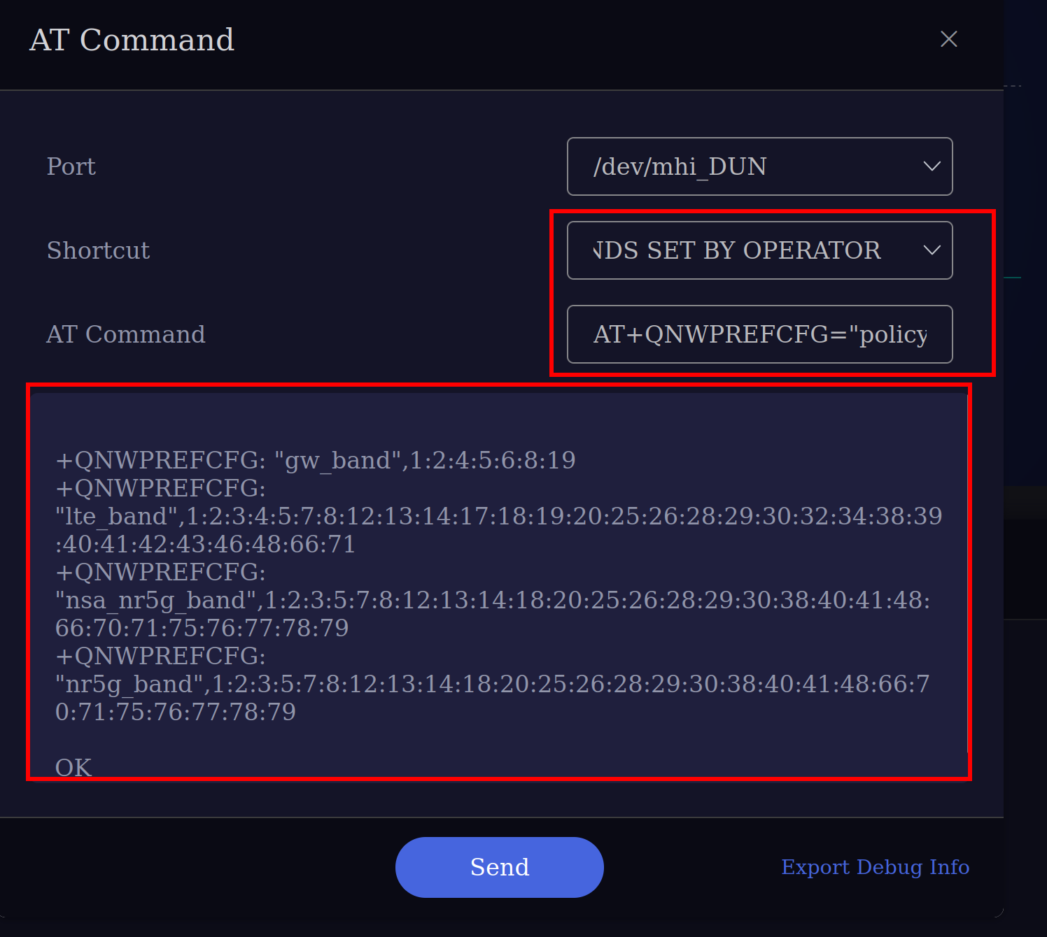

  2. Verify it by logging into the web interface:

This is going to save a lot of time, especially when logging into the web UI from a mobile device. Don’t need to copy/paste AT commands anymore :slight_smile:
Added custom AT commands to UI of AXT1800. I’ll add to AX3000 later.
