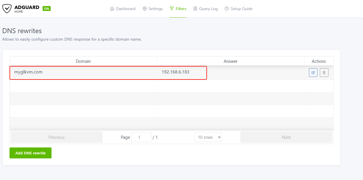

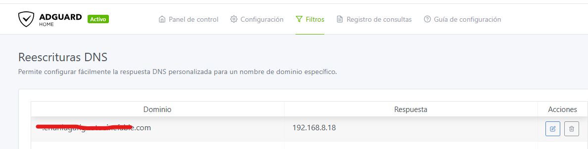

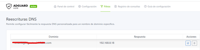

Now I’ve installed a Nextcloud wich is not published, I use it only internally but I use a domain so I’ve created a DNS rewrites in my Adguard.
I also use this methot to access internally to my other services when I’m conected to the wifi instead via public network.
mysupoercooldomain.com 192.168.8.18.

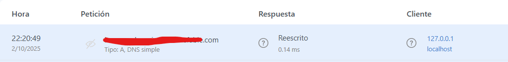

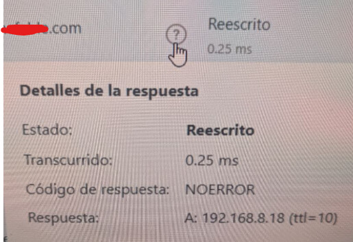

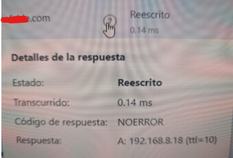

Works like a charm when I’m in the LAN, I see this in the Adguard log

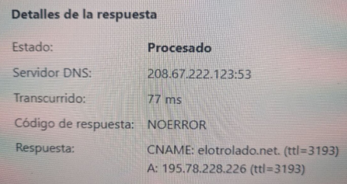

I see this (I’ve done the test using my Android Phone conected to the Flint using the official wireguard app)
When I access to a not rewrited URL

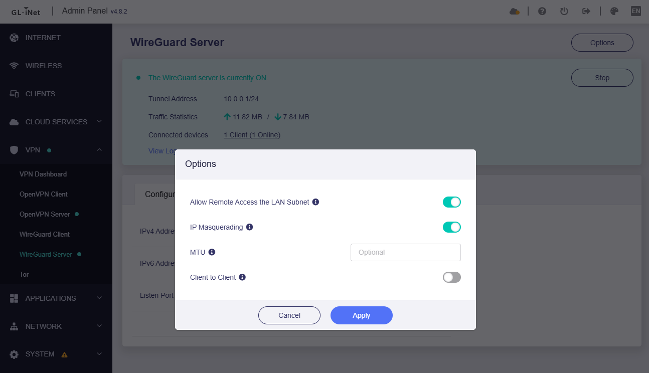

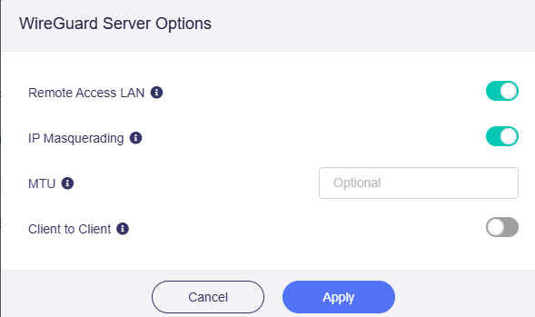

This are my wireguard server options

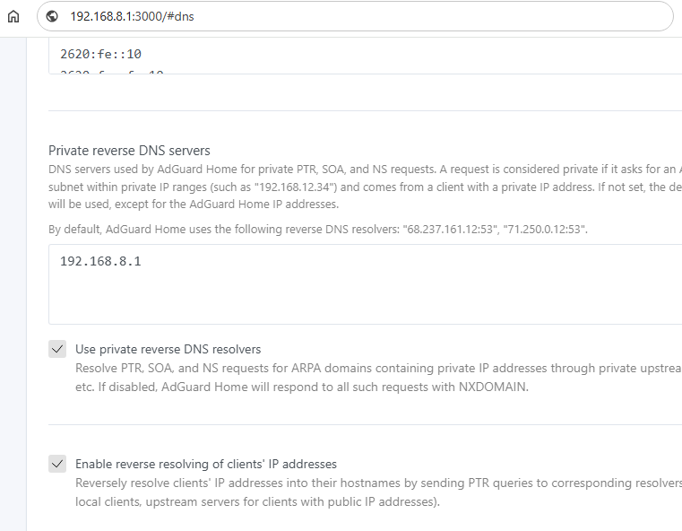

This is my DNS configuration

Try adding your router’s IP in the Private reverse DNS servers.
Thanks for your reply.
I’ve tried but nothing have changed

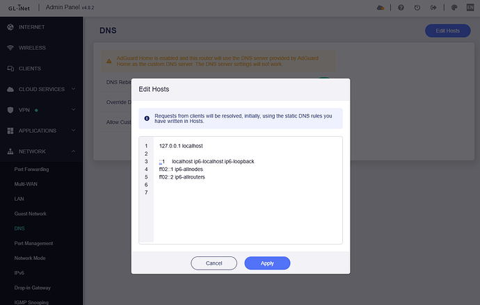

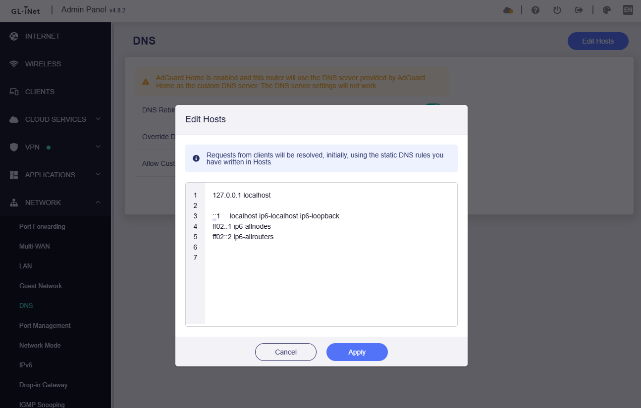

I’ve also tried with the /etc/hosts with no result.
Unable to resolve host “mydomain”

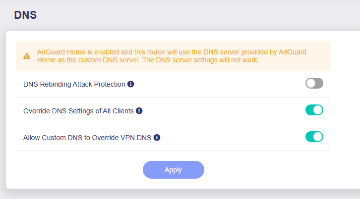

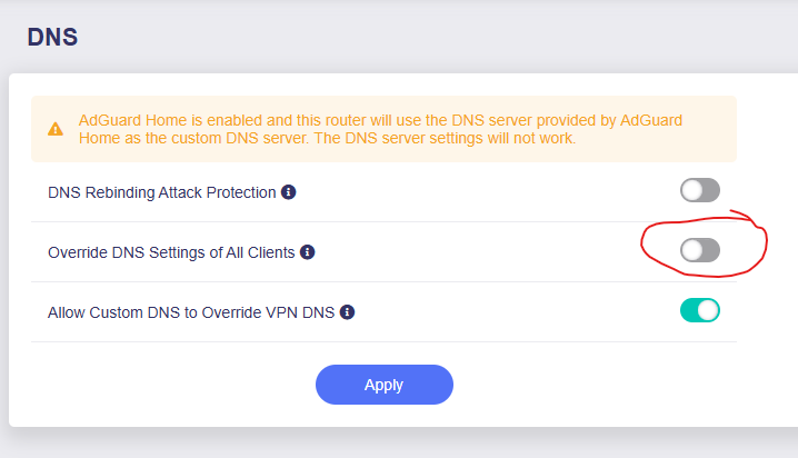

I’ve found the solution but I don’t like it
it works if you disable the DNS rebinding attack protection.
I don’t undertand 2 things.
  1. Why this dns settings is workinf if i’m usind ADGuard the there is a message that tells you that will don’t work?
  2. Why is working with the prtection when I’m connected to my lan but I have to disable it when I’m connected via VPN?

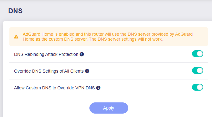

There is a comment next to DNS rebinding attack protection, I believe it will answer your question more clearly:
Turning this option on may cause private DNS lookup failure. If your network has a captive portal please disable this option.
When ADG handles client requests enabled, the DNS server section of the current page cannot be set, but these three DNS options do work/effect.
For requests made through a VPN, the subnet of the client that initiates the request does not match your router's own subnet, so the router will treat DNS requests from non-local subnets as a rebinding attack and will drop this part traffic.

I have found another strange behavior.

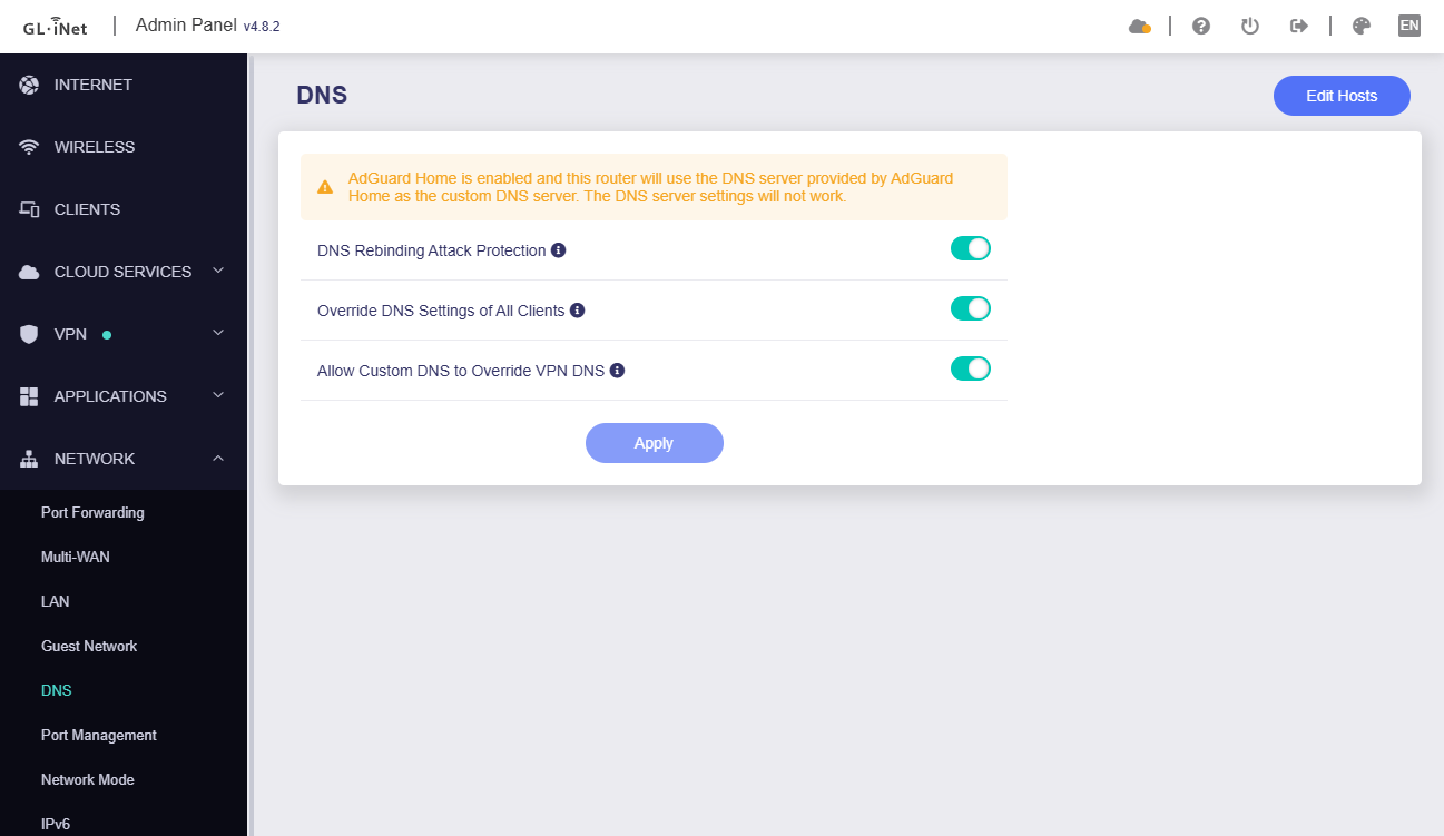

On the same DNS options page I have disabled this and it does not apply either since I see everything go through adguard and I have DNS 8.8.8.8 on the server.
I think there is a problem and those options are not being applied well.
Have you customized the DNS server 8.8.8.8 on a specified client (like PC), but are the client’s DNS requests still processed by ADG of router, instead of being sent to 8.8.8.8?

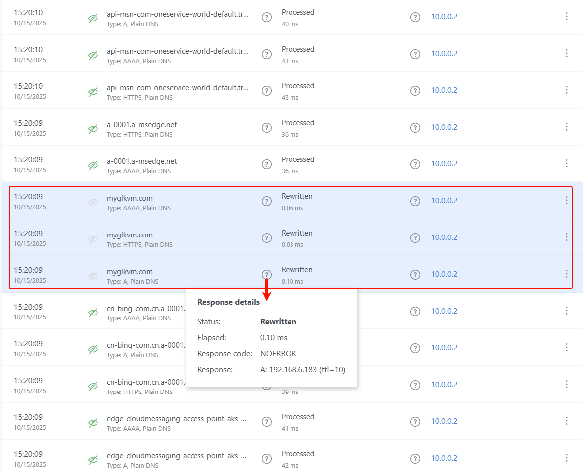

I don’t own Pixel 7, so I tested it with iPhone, but didn’t reproduce the issue you mentioned.
VPN server: Flint/AX1800, v4.8.2
VPN client: iPhone, iOS 16
  1. Please check if you enabled secure DNS on Pixel 7 OS or browser.
  2. Please try to test again with other clients (other systems).

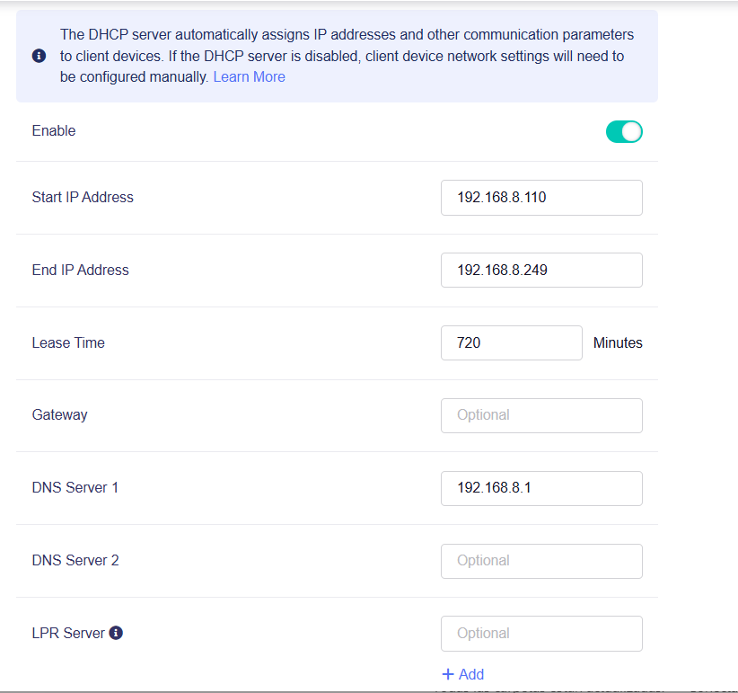

This is my Flint DHCP configuration
