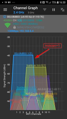

Well I tested it on a very busy 2.4GHz band and it seems it does force 40 MHz
GL-iNET default:
OpenWRT default (and unpatched hostapd):

You see that on the SSID scanner app as it parses the beacon frame - when in HT20_HT40, the beacon will reflect the wide channel in the htcaps stanza (which is appropriate). Some AP’s will dynamically update the beacon frame if conditions are not good enough for 40MHz channels (I’ve seen this with Marvell closed source drivers on the WRT products)
To really tell, one has to use a spectrum analyzer where you can see both the primary channel, along with the secondary when conditions allow traffic to be sent on the secondary.
