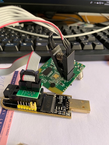

Ey! Sorry, I couldn’t write you. I didn’t used a raspberry. I bought a chip programmer. and flashed a bin50029e61553e06cca53c441aec476f9e1d3f607d_2_375x500

Is this a: CH341A 24 25 Series EEPROM Flasher BIOS USB Programmer
You used?
Yes, the kit with the test clip. Not all sellers include it.
I have ordered one on EBAY, in the picture the clip is there I just have to wait until it arrives.
