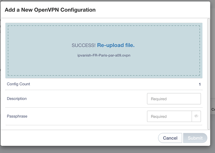

My ar300m running the latest firmware can’t import ipvanish openvpn config.

alzhao
2
what does the UI say when you upload?
It shows no field for username and password. Just description and passphrase. Please see the screenshot.
alzhao
4
When you have auth-user-pass it should ask for username and password. So this is a bug. What is the firmware version you have?

Upgraded to testing firmware 3.0.26. Still no luck. It doesn’t ask for username and password.

I tried and confirmed it. Forwarded to engineer to check.
lancer
8
It should be that the certificate file ‘ca.ipvanish.com.crt’ was not found. Please check if the certificate file was uploaded together.
No I’ve copied that file into /etc/openvpn
alzhao
10
You need to zip it with the ovpn and upload via the UI.
This solved it. Thanks you very much.
