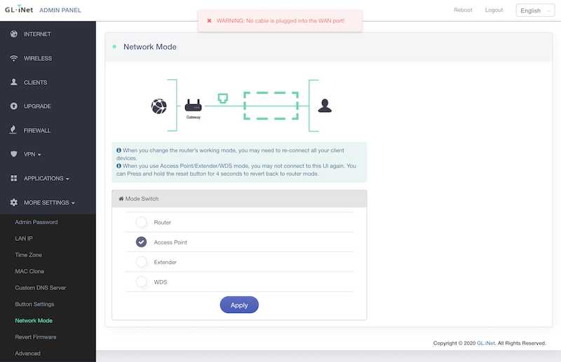

Hello, I’m setting up a GL-MT300N-V2-3a1 to be the access point for my modem/router, so that I can create a WI-FI network connected to a VPN, which my old router cannot use.
I’m reopening this thread because your experience could be of huge help, but I don’t know if the different router could be a problem; in that case please advice and I’ll open a new thread.

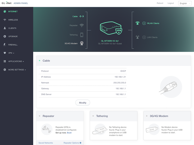

The VPN router is connected to the other one through a LAN cable entering the WAN port. DHCP is set and I can access the internet; no VPN is set by now. Current version is 3.102, no updates available.

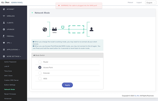

When trying to change network mode to access point the ui complains that no cable is plugged into the WAN port, which is false.
How can I solve this?

Thanks, but the upgrade didn’t solve

I just treid 3.102 firmware and I do not have this problem.
This should be a bug in a very old firmware. But not in 3.102 and 3.104. What browser are you using?
