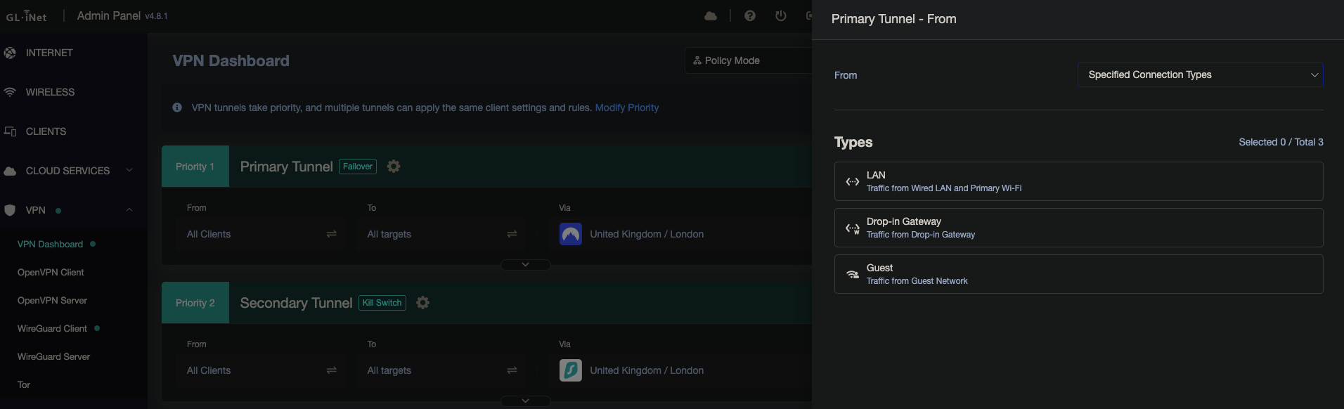

I want to be able to have multiple running VPN instances from different providers, i.e., Surfshark, NordVPN, etc, whilst also seamlessly using the dedicated DNS for the VPN provider currently in use. All whilst still having Adguard Home adblock filtering working.

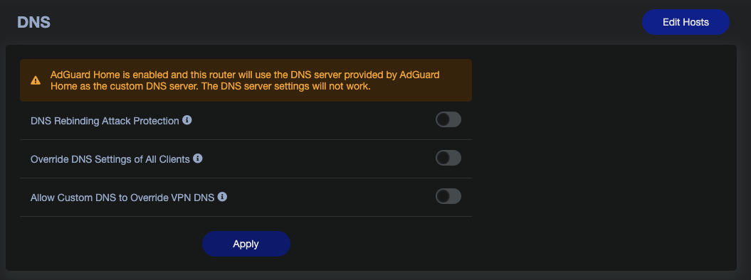

“Allow Custom DNS to Override VPN DNS” = ON + 2 VPN Tunnels (Surfshark & NordVPN) + ADG enabled = all VPN tunnels use the upstream DNS, but this means when the VPN tunnels failover, the correct VPN DNS isn't being used. If Upstream DNS is left blank (same for fallback DNS), Cloudflare DNS is being used.
“Allow Custom DNS to Override VPN DNS” = OFF + 2 VPN Tunnels (Surfshark & NordVPN) + ADG enabled = the correct VPN DNS is being used when VPNs change but there's no ADG filtering taking place.
Therefore, the question still remains - how can I have 2 active VPN tunnels, from different VPN providers, whilst using their dedicated DNS. Add to that, we still need ADG to filter traffic for ad/trackers, etc.
As it currently stands, this doesn't seem to be possible? Unless there's another way of achieving this @bruce ?
Adguard DNS will override "vpn dns" if “Allow Custom DNS to Override VPN DNS” = on.
On the other hand, AdG upstream query can use a different tunnel according to the rule.
We'll address a bug for the rule that has ”Specified Connection Types“ from-settings.
You can try snapshot firmware if you set that.
In this scenario, please try to turn off DNS cache for AdG.

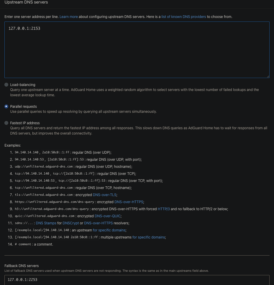

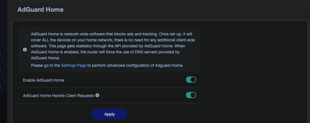

This is to forward DNS requests from client devices to Adguard Home when not enabling “Allow Custom DNS to Override VPN DNS” & "Override DNS Settings of All Clients".
Note:Before modifying, remember to back up this file to avoid any accidental operations that may mess up the firewall settings. Otherwise, you will need to reset the router to recover.

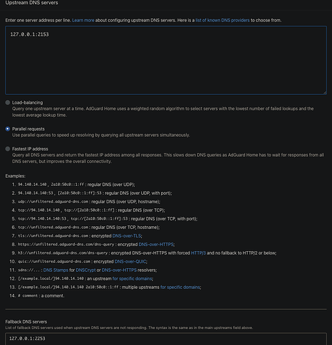

AdGuard Home DNS settings:
Upstream DNS servers:127.0.0.1:2153
Fallback DNS servers:127.0.0.1:2253
When the VPN type is Wireguard Client
The dnsmasq instance for the Primary Tunnel listens on port 2153
The dnsmasq instance for the Secondary Tunnel listens on port 2253
This is the configuration for Adguard Home to forward DNS requests to the corresponding VPN dnsmasq instance.

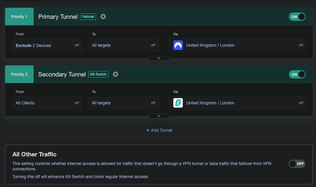

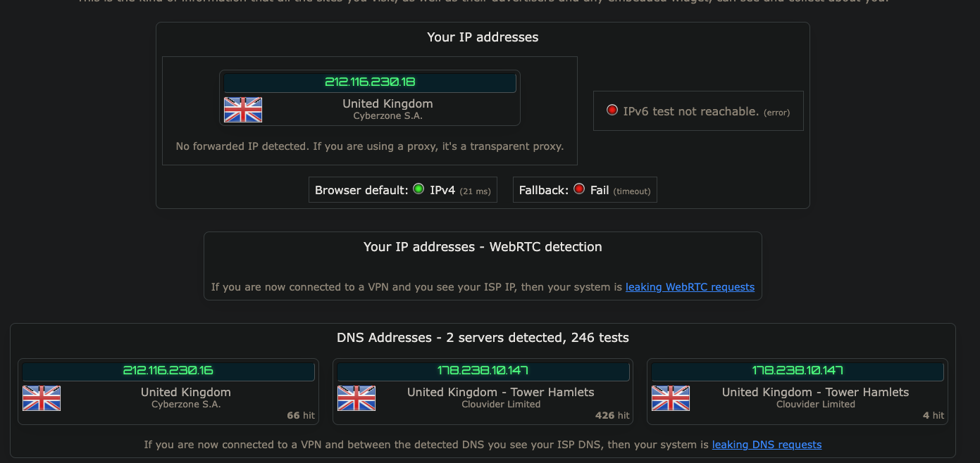

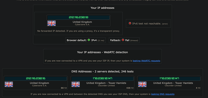

Now, when the failover happens, I can see the DNS from the Primary Tunnel in the IP Leak tests (Clouvider Limited). My assumption was that when we failover to the Secondary Tunnel, only that VPN DNS should be visible? Am I missing something?
This solution only applies when the Primary Tunnel is truly disconnected — the dnsmasq instance tied to that tunnel will become unavailable.
For testing, consider deploying a WireGuard (WG) server inside your internal network.
That lets you simulate a Primary Tunnel failure simply by stopping the local WG server.
