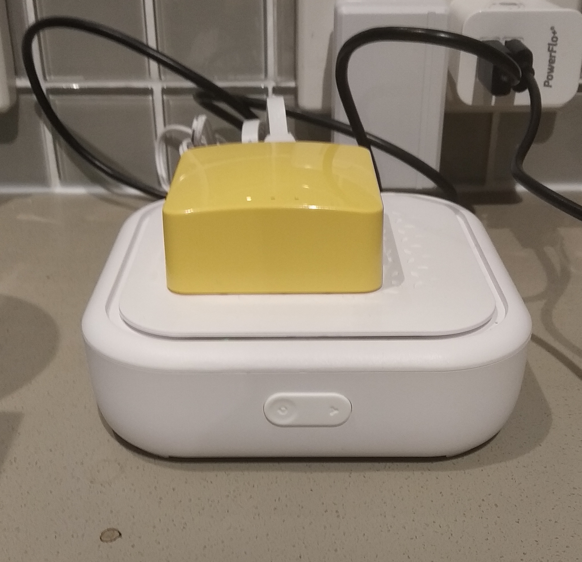

My setup because I don’t have access to the main router. WISP mode Mango with WiFi off connected to Master node :blush:
Do you think I could run the Mango off the USB port of the B1300?
Speeds just as good as connecting to the “source/master” router at both master and slave node locations :slight_smile:
You should be able to run the Mango from the b1300. I’m running a Ar750 off my b1300 without any issue. In fact I also have a USB camera connected to the ar750.
