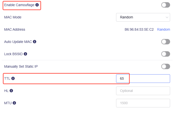

Please try to enable the "Enable Camouflage" and setup TTL 65 in repeater:

is this the same as the TTL mangling needed on cruise liners? When will this be available on Beryl MT1300?

  2. If no luck, please connects the MSC portal 2.4G WiFi on repeater of MT1300, and try to SSH to router:
mkdir -p /usr/share/nftables.d/chain-pre/mangle_prerouting
echo 'iifname wlan-sta0 counter ip ttl set 64' > /usr/share/nftables.d/chain-pre/mangle_prerouting/01-set-ttl-portal.nft
/etc/init.d/firewall reload
If the above commands do not work, please try this:
iptables -t mangle -A PREROUTING -i wlan-sta0 -j TTL --ttl-set 64
A TTL of 128 will spoof the default on a Windows machine. 64 is typical of OSX & Linux:
uci batch <<- __EOF
	add firewall rule
	rename firewall.@rule[-1]='custom_ttl'
	set firewall.custom_ttl.name='Set TTL to 128'
	set firewall.custom_ttl.src='wan'
	set firewall.custom_ttl.proto='ip'
	set firewall.custom_ttl.target='ACCEPT'
	set firewall.custom_ttl.ttl='128'
	reorder firewall.custom_ttl='1'
	set firewall.custom_ttl.enabled='1'
__EOF
uci commit firewall && service firewall restart
