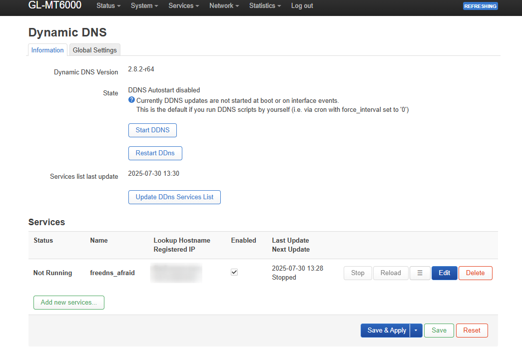

DDNS error after upgrading from 4.7.5-op24 to 4.8 4.8.0-op24

It works perfectly fine for me, with custom ddns provider.
Did you try reconfiguring the service?
