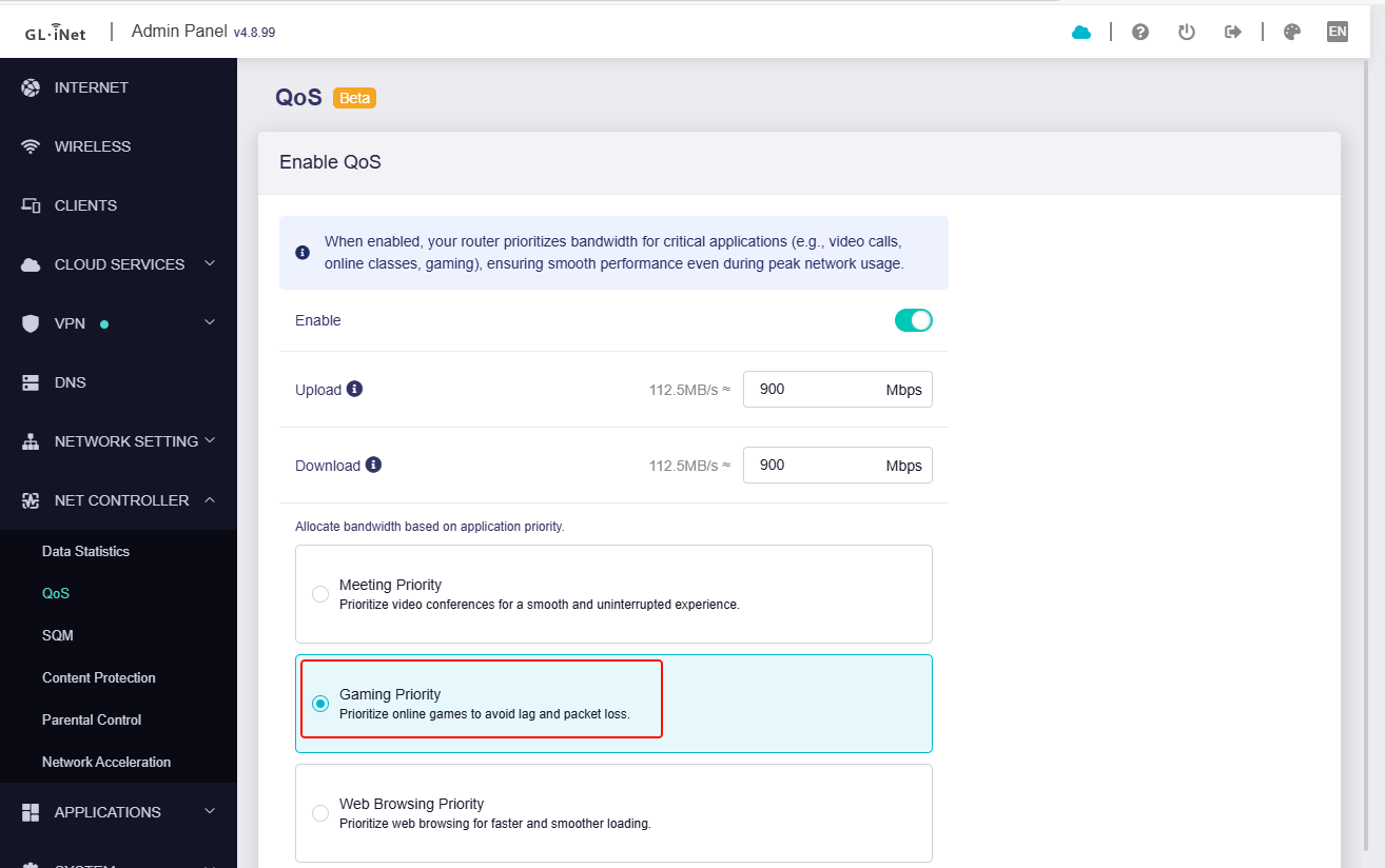

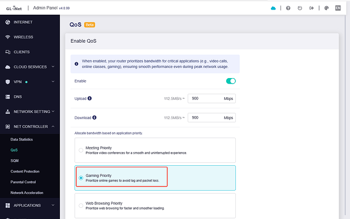

It's not the physical ports. It's network ports. For example a game like counter strike 2 uses 27015-27050 range UDP Outbound ports for the multiplayer gameplay. So when the router detects the that port range in outboard being used, it can prioritize the game’s traffic on that port range. So an option that allows adding applications that may not be in the DPI by custom port range would be nice.
May I know if we have already selected for the Games category in the higher priority, but you want to customize the port (UDP) to bring it is at the highest priority, right?

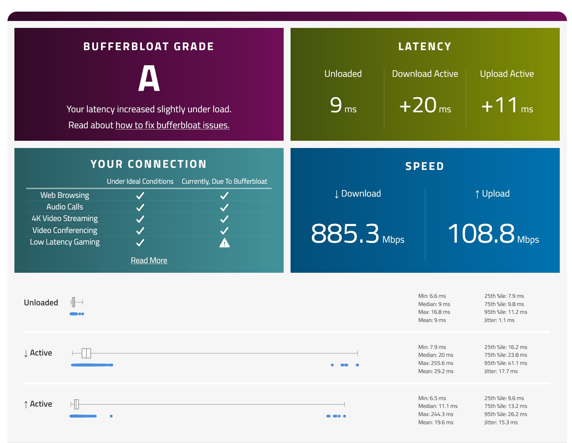

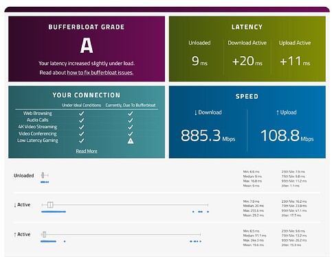

Question for those that need SQM: what is your latency?
I don’t see any advantage for disabling the hardware acceleration (to enable the SQM) just to have a so small benefit (in my scenario, 11ms).
My internet speed is 900Mbps/115Mbps.

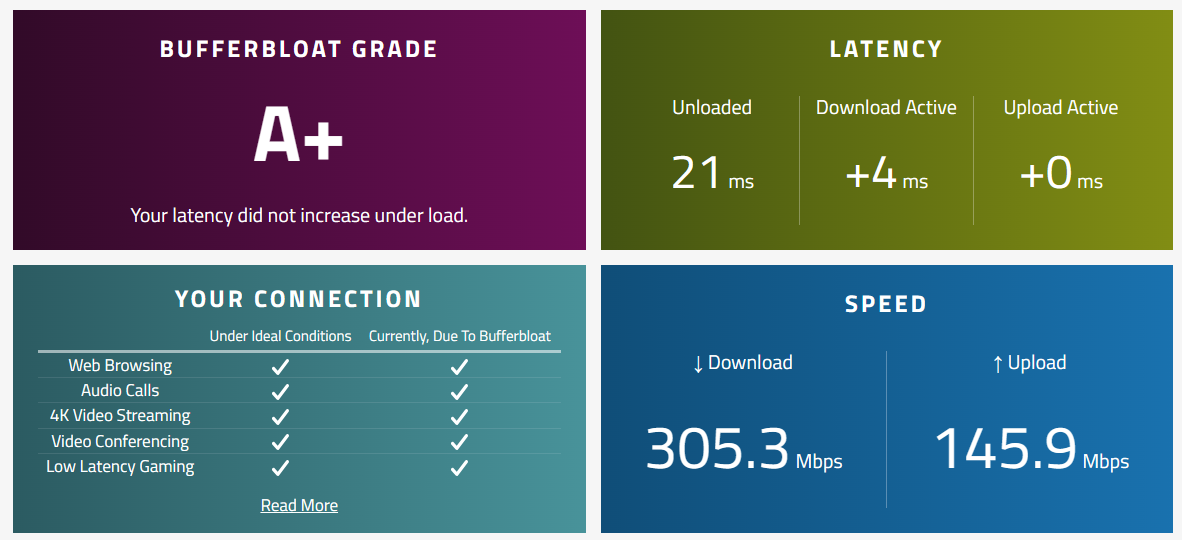

I’m on Vanilla OpenWrt 24.10.4 (no SQM):

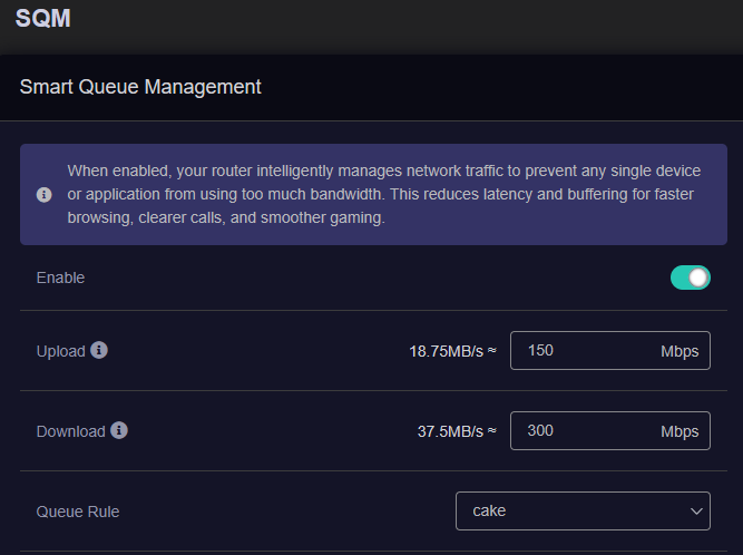

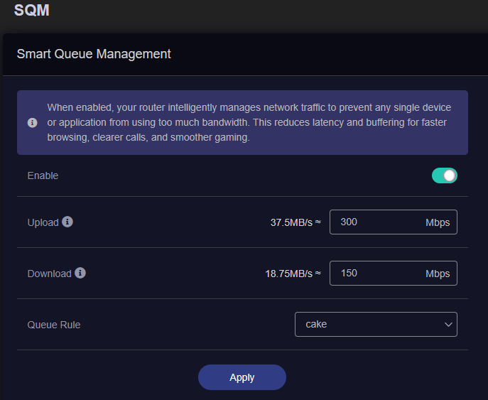

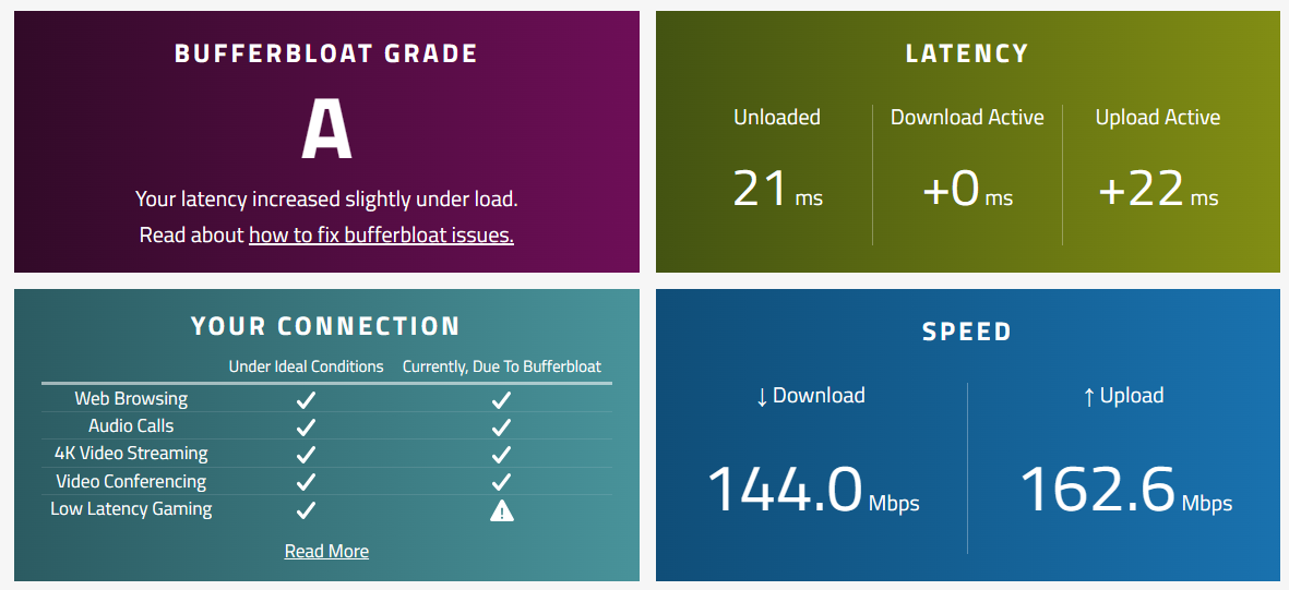

Upload/Download speeds on SQM seems upsidedown. My line is 300up/150dn Fiber.
Flint 2.
vs
impressive.

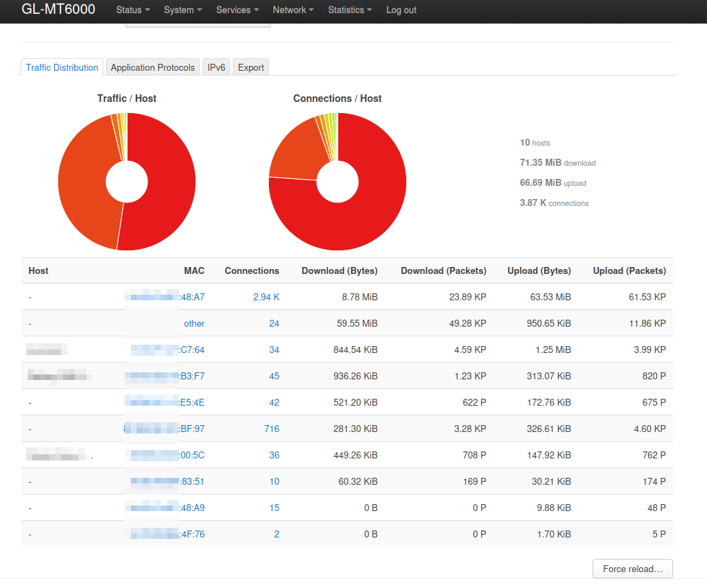

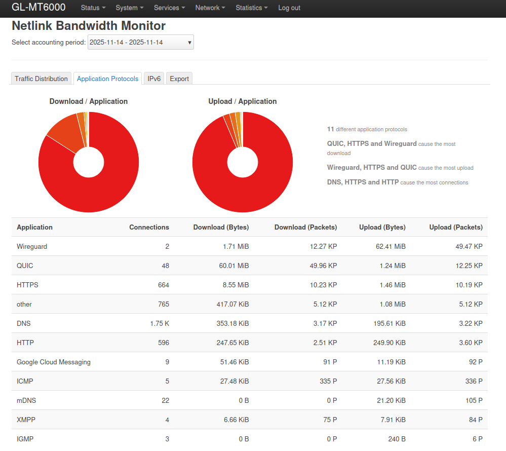

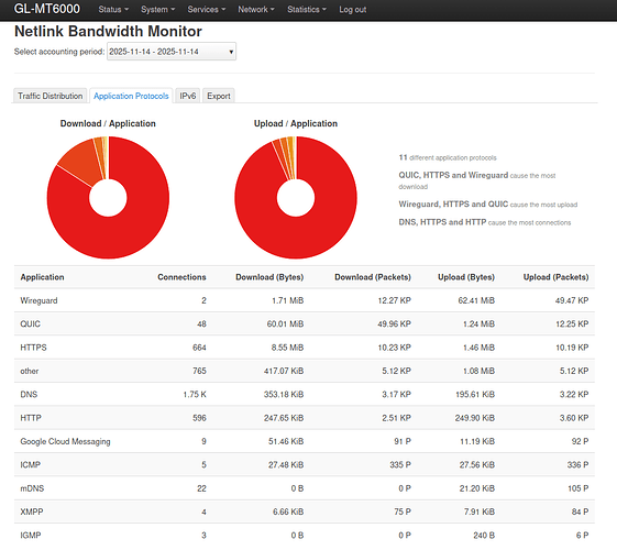

can some one send image of statistic feature, i already use (Netlink Bandwidth Monitor)
Was using wired. Since someone mentioned the same problem in this thread I installed the sqm in luci to find out gl.inet chose to apply sqm to br-lan instead of the default WAN, this is why bandwidth limits are reversed in the main page.
After changing the sqm target to wan the gl.inet sqm page is now limiting the correct sides.
Also for the next release I suggest adding more features to your sqm page since it has many important dials you are missing. For example please consider using this Asus cake page as guidance where it includes most of the dials to fit your connection and usage. overhead, MPU, ack filter, fairness keywords are all important.
