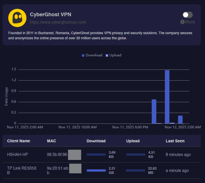

I installed the beta on my Flint 2 a few hours ago and have reason to believe that the detection logic for CyberGhost isn’t correct.

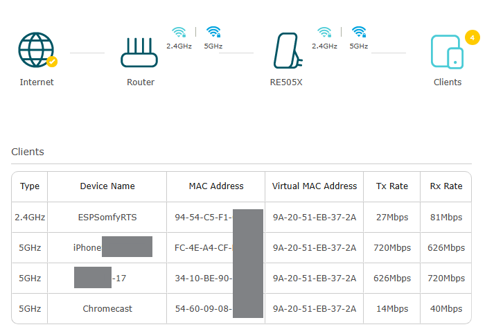

Traffic through the TP Link RE505X (set up as a repeater) is being categorised as CyberGhost.
HSHAH-HP is the laptop I’m currently using and it’s only a few metres from the Flint 2 so it wouldn’t be connecting via the TP Link device.
Thanks for your feedback.
Please check your TP-Link router and the LAN client connected to this router, is the WG/OpenVPN enabled and connected to this VPN provider?

I have nothing configured or enabled under VPN on the Flint 2. The TP Link is simply extending the Flint 2’s WiFi - SSID is the same for both 2.4GHz and 5GHz as well as the same for both Flint 2 and TP Link.
There are no VPNs involved. If there were, it would be NordVPN. Definitely not CyberGhost.
