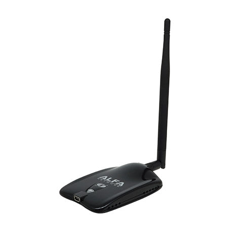

Yeah, they’re getting harder to find these days - but the ath9k alfa’s are good, but as noted, buyer beware…
AR9271 USB devices are actually more expensive than the AR150 or USB150 because of supply and demand
