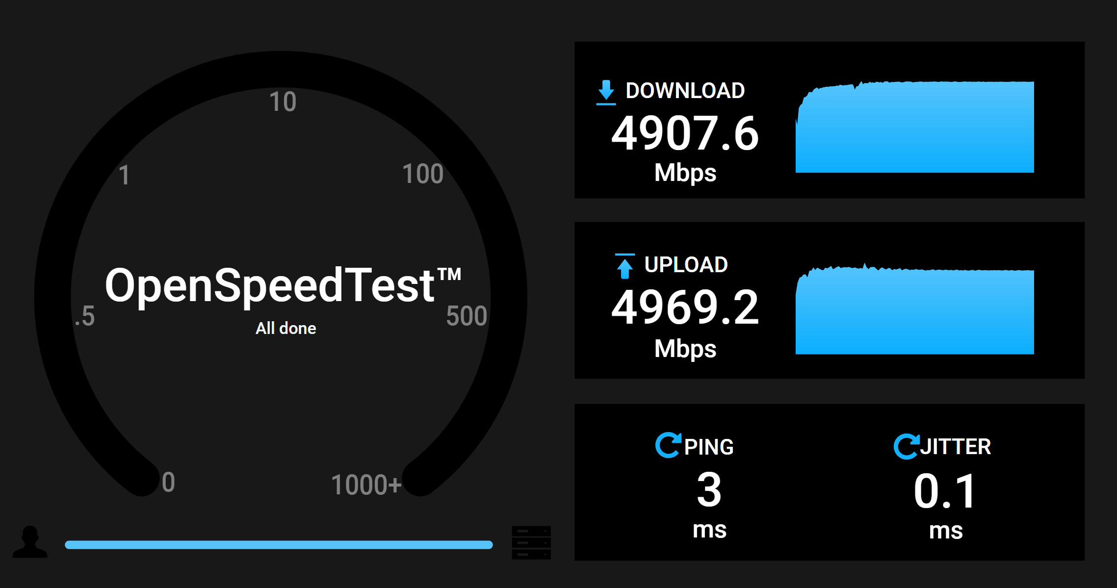

One test would materially narrow this down: with the second Flint 4 in AP mode on 4.11.0, connect a PC by Ethernet directly to one of its LAN ports and run bidirectional iperf3 tests against the Ubuntu server, while leaving the existing SFP+ backhaul unchanged.
If the wired client also has poor server-to-client throughput, the issue is in the secondary unit’s forwarding/backhaul path. If wired throughput is normal while 6 GHz download remains slow, it isolates the problem to the secondary unit’s Wi-Fi downlink path. Please report both directions and the negotiated Ethernet link speed; there is no need to repeat every HNAT combination initially.
my PC on the switch has a 5Gbps Rj45 port, I connected that to the 10Gb port on the Second Flint 4 in AP mode and got nearly 5gbps both sides on a LAN speed test and iperf3.
iperf3 results:
iperf3 -c 192.168.1.11 -P 16 --bidir

The posted iperf3 --bidir result is not nearly 5 Gbps in both directions: client-to-server reaches 4.73 Gbps, but server-to-client averages only 494 Mbps with 911 retransmissions. That asymmetry closely matches the impaired download direction, although simultaneous bidirectional traffic may itself influence the result.
Please run the directions separately to remove that variable:
iperf3 -c 192.168.1.11 -P 8 -t 30
iperf3 -c 192.168.1.11 -P 8 -t 30 -R
Please share only the final [SUM] sender/receiver lines and retransmission counts. If the reverse-only test remains slow, the fault is also present on the wired path through the second Flint 4; if it reaches approximately 5 Gbps, the low --bidir reverse result is caused by simultaneous traffic and the original AP-mode issue remains isolated to Wi-Fi downlink.
I think the retransmissions are from flow control not being enabled on both sides on the motherboard 5gb port and on the 10gb port on the second flint 4, however usually flow control enabled does actually make the speeds slower. Regardless even with flow control disabled I don’t have the download speed issues and my LAN speeds are faster than a Wifi test on the PC also connected to the 6Ghz.
Results:
[SUM] 0.00-30.01 sec 16.6 GBytes 4.75 Gbits/sec sender
[SUM] 0.00-30.04 sec 16.6 GBytes 4.75 Gbits/sec receiver
[SUM] 0.00-30.01 sec 16.6 GBytes 4.74 Gbits/sec 103403 sender
[SUM] 0.00-30.01 sec 16.5 GBytes 4.74 Gbits/sec receiver
The separate tests show about 4.74–4.75 Gbps in both directions, so the second Flint 4’s wired forwarding/backhaul path is not imposing the reported download cap. This narrows the AP-mode LAN issue to the secondary unit’s Wi‑Fi downlink path rather than its SFP+ backhaul or Ethernet bridge.
The high reverse-test retransmission count indicates packet loss or congestion at this near-line-rate load, but because throughput still reaches 4.74 Gbps, it does not explain the much lower Wi‑Fi download result. These results should be sufficient for staff’s reproduction work; no further HNAT combinations are needed for this isolation test.

I just done another test and connected the 2nd Flint 4 directly via Ethernet without the switch and got the same upload speed issue on the internet speed test.
