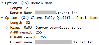

Before:
  • dhcp.@dnsmasq[0].domain='lan'
After turn on Tailscale:
  • dhcp.@dnsmasq[0].domain='tail000.ts.net lan' -or- 'ts.net lan'
On Windows
Result:
  • The router sends "tail000.ts.net lan" as option 15 but this option allows only a single domain.
  • This also applies if the client requested option 119 in option 55 of the request. And no matter whether option 119 is requested, option 15 must be a single domain.
  • Therefore, DHCP clients make queries like "hostname.tail000.ts.net lan" which violates the spec
  • Both domain query(like "hostname.lan") and MagicDNS would fail
