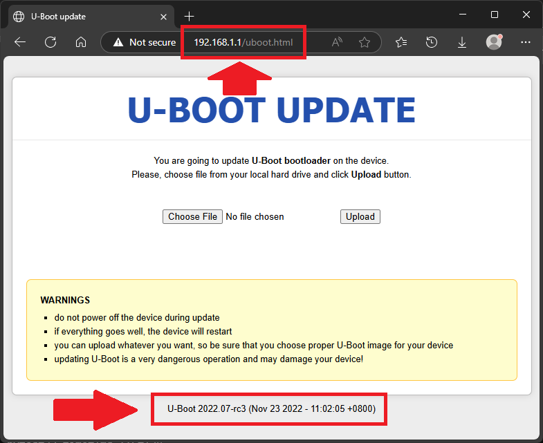

Please confirm you are using the URL: http://192.168.1.1/uboot.html
It should look like this:
Note the URL and the U-Boot version on the bottom of the page, please note this from a Beryl AX so may not be the same as a Flint or Slate model.

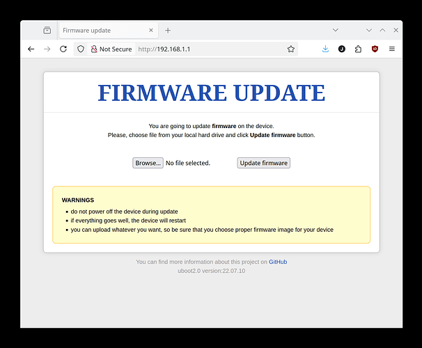

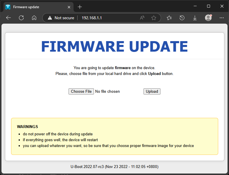

Here is what the standard U-boot Recovery URL (http://192.168.1.1) looks like:
Hey, @bruce, does GL.iNet have any comment if the U-boot version is expected to be the same for all currently supported devices or should there be an expectation some may be running different/older versions? TIA.

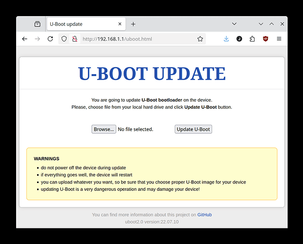

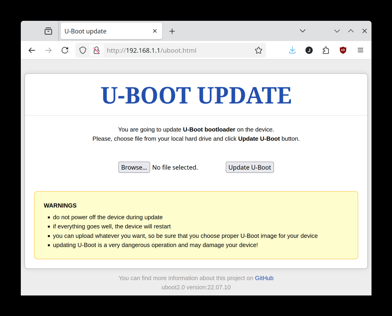

Here is what my U-Boot recovery page looks like now. The title of the page is "U-Boot Update" rather than "Firmware Update" and the link to the GitHub URL GitHub - pepe2k/u-boot_mod: U-Boot 1.1.4 modification for routers suggests but doesn't confirm that the U-Boot update has taken place.
That's because you're looking at /uboot.html. Try just 192.168.1.1
Your screen shot shows uboot2.0 version: 22.07.10. That is a noticeable difference vs @j_c 's posted version, build date. To confirm, you did upload the aforementioned U-boot update via the 'U-BOOT UPDATE' page, correct? The device might need to be power cycled but that's just me speculating.
( Note: @j_c is using a release candidate (2022.07-rc3 dated Nov 23 2022- 11:02:05 +0800). I'd be hesitant to flash a bootloader with a non-stable build. )

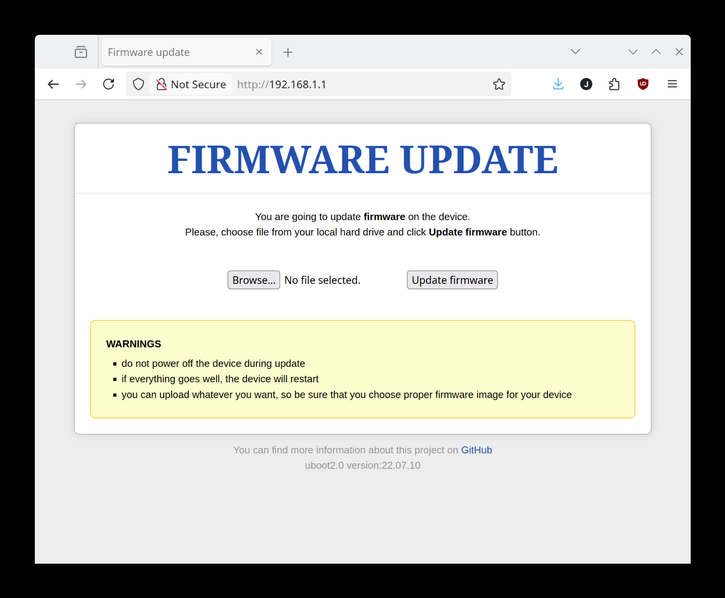

I thought that's what I was supposed to be looking at. But just to confirm, here's 192.168.1.1 whicp appears to be identical:
I did follow the instructions to upload the U-boot update. Perhaps I should try it again, or with a different update? The device has been power cycled (many times) since then.
