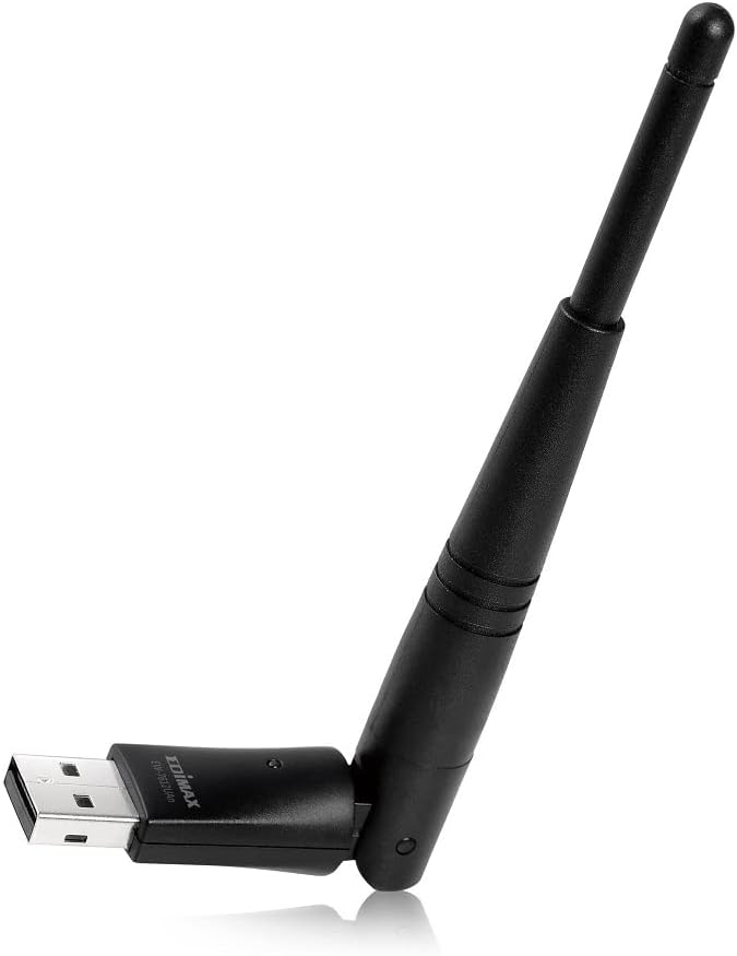

EDIMAX W-7612UAn-V2
is 3 dbi enough?.. apparently this is RTL8192CU chipset which seems to have kernel module and firmware in the repos:
source: Edimax EW-7612UAn v2 - DeviWiki (ex WikiDevi)
