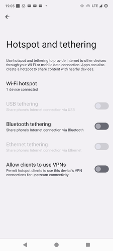

I think it may be possible to send tethered data through the tunnel on a rooted phone but don’t quote me on that.
Which phone is this? Asus phones don’t do this natively.
A phone running LineageOS 20 (Android 13)
Wow. Does Pixel 7 have this?
It should. I can’t be sure, tho.
Have what? The ability to flash LineageOS 20? Yes. But flashing ROM’s on phones is not recommended for the inexperienced. And, you will need to unlock the bootloader which you can’t do on Pixels purchased from Verizon.
I think this feature could be in the pixel stock os, lineage doesn’t diverge very much from aosp.
You can run an Android proxy server app to have http/https traffic go through VPN, such as PdaNet+ (pay) or Every Proxy (free and my preferred). Android smartphone/tablet, Windows PC, iPad and Mac all have native proxy clients. GL.iNet/OpenWRT routers do not have native proxy client, which is another reason that I do not bring a router when travelling anymore.
Stock Android on Pixel phones does not have that bottom option to route the tethered data through the VPN tunnel.
My pixel 6a, Google Fi, does not.
Checked on an old Nexus 7 with recent LineageOS. It has this VPN toggle. However, it can’t be at the same time connected to wifi and have hotspot enabled. In other words, sharing a wifi internet connection through wifi isn’t possible. I think it isn’t even possible through USB or Bluetooth as I can’t turn on hotspot without wifi turning off by it self. Unless there’s a hidden setting somewhere, I think this feature depends on a device.
That could depend on the hardware.
