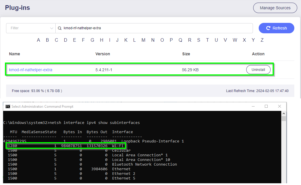

Try this method, install nat helper extra in the router.
opkg update
opkg install kmod-nf-nathelper-extra
If the above does not solve your issue, on your windows, set the mtu value lower.
#first find out the network interface to Spitz AX
netsh interface ipv4 show subinterfaces
#Then set up mtu to 1280. Pls do replace the interface name in <>
netsh interface ipv4 set subinterface <subinterface name> mtu=1280 store=persistent

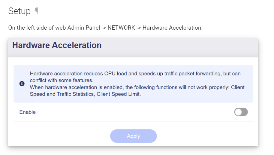

I tried the suggestions here: VPN Passthrough
but get the same error, L2TP connection failed

Installed the packages
opkg update

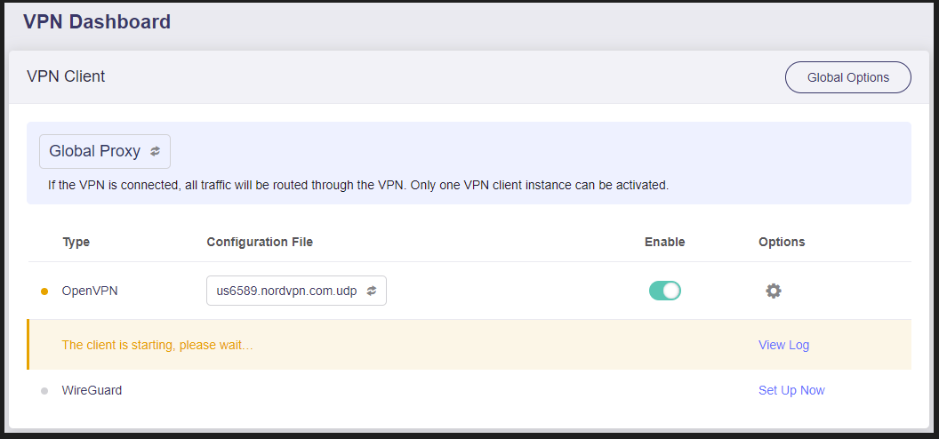

As an additional experiment I tried running an OpenVPN client on the Spitz AX using my NordVPN account to see if that could workaround the issue, but that doesn’t work and there is a separate issue. The client is stuck trying to start…
Thanks guys for the additional suggestions! I did get the NordVPN client to run on the Spitz AX after updating the credentials. It’s interesting that a different set of credentials are required for the NordVPN service credentials. However, even after getting the NordVPN client running on the Spitz AX between the WAN and LAN, I’m still not able to connect to my office VPN.
