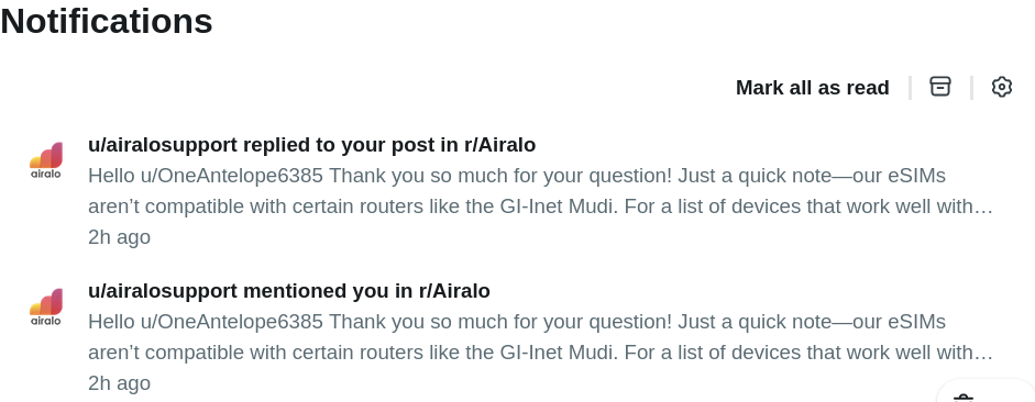

Airalo reddit support said that their esim is not compatible with certain routers, like Mudi.

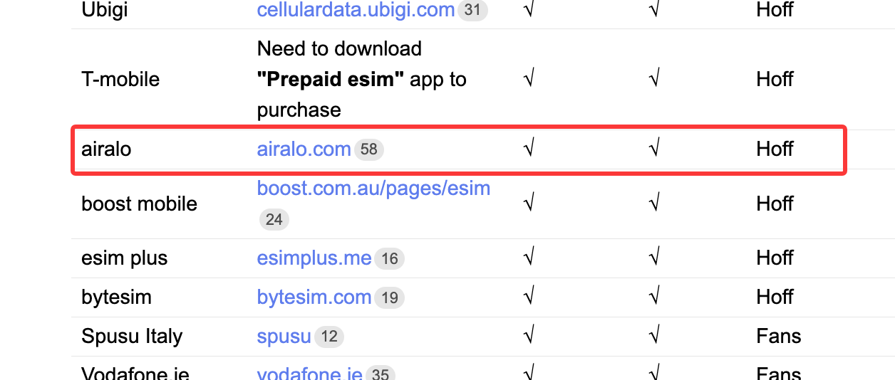

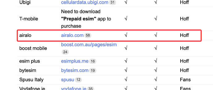

Hi Rossoneru, I think you don’t worry it, we have tested it, it can work, do you test or do you encounter problems with Airalo?
Yes, I’ve tested and the profile isn’t downloading, it stops at 30%. I’m using eiotclub physical esim in my mudi-v2. I was looking for an alternative to Nomad esim (which works on mudi+eiot) but Airalo doesnt download. Their support said what it said. I wonder if anyone else can offer some feedback on this.

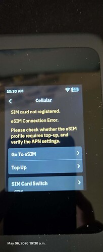

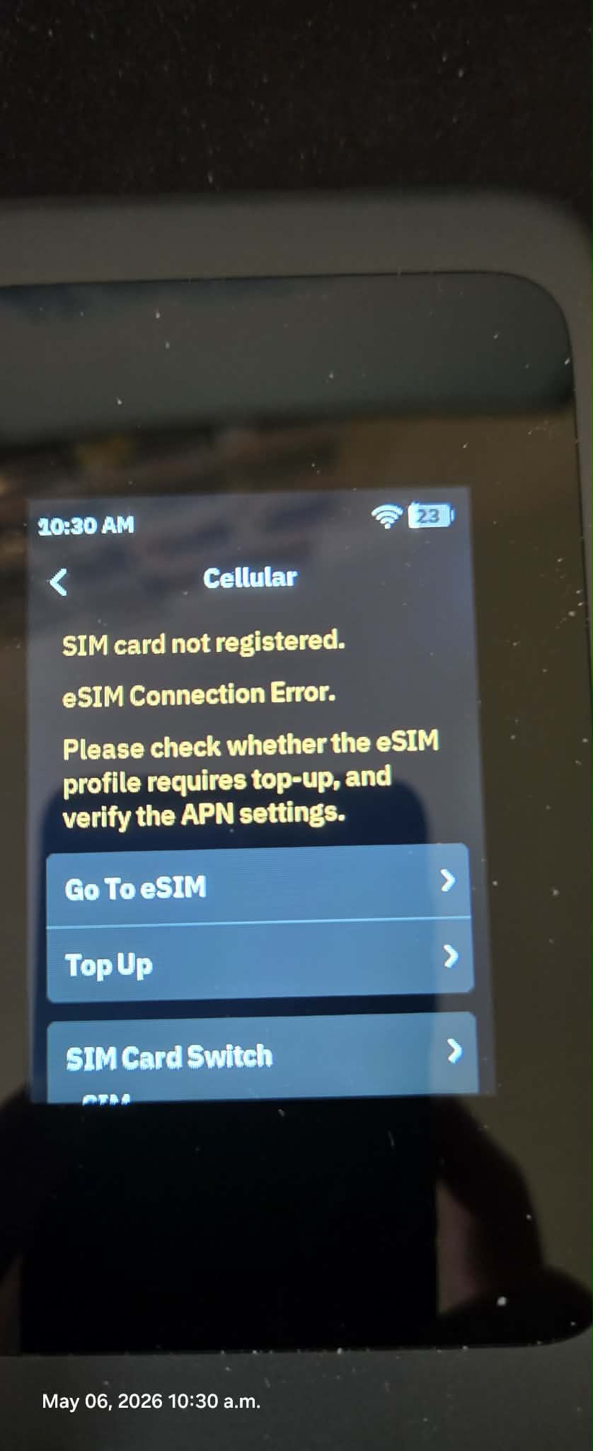

Has anyone been able to successfully enable an Orange eSIM on the EIOTCLUB sim as of April 2026?
If not, I’ll give it a shot again in June when I’m in Italy.
