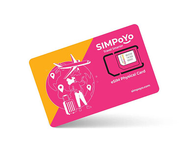

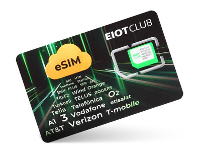

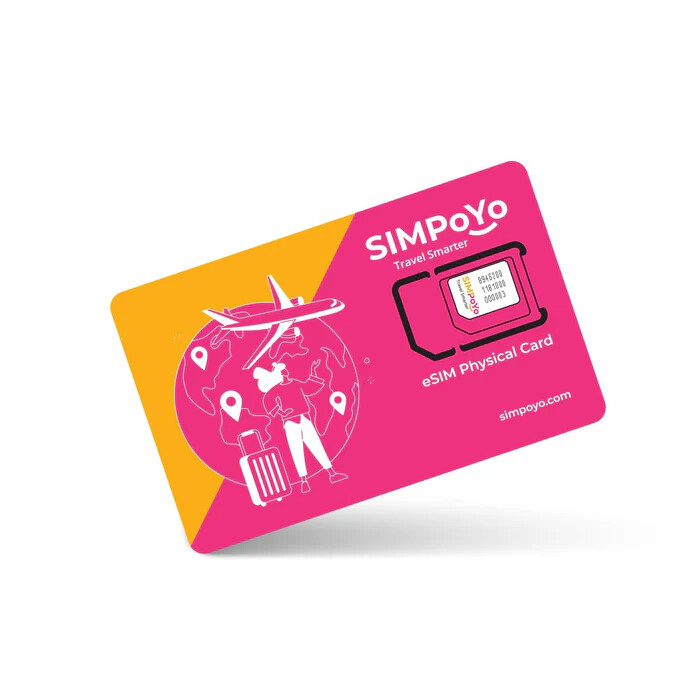

Carriers supported by GL.iNet physical eSIM
GL.iNet offers two physical eSIM cards: EIOTCLUB eSIM card & SIMPoYo eSIM Card.
Here is a list of supported eSIM stores that have been tested by GL.iNet and friendly users:
