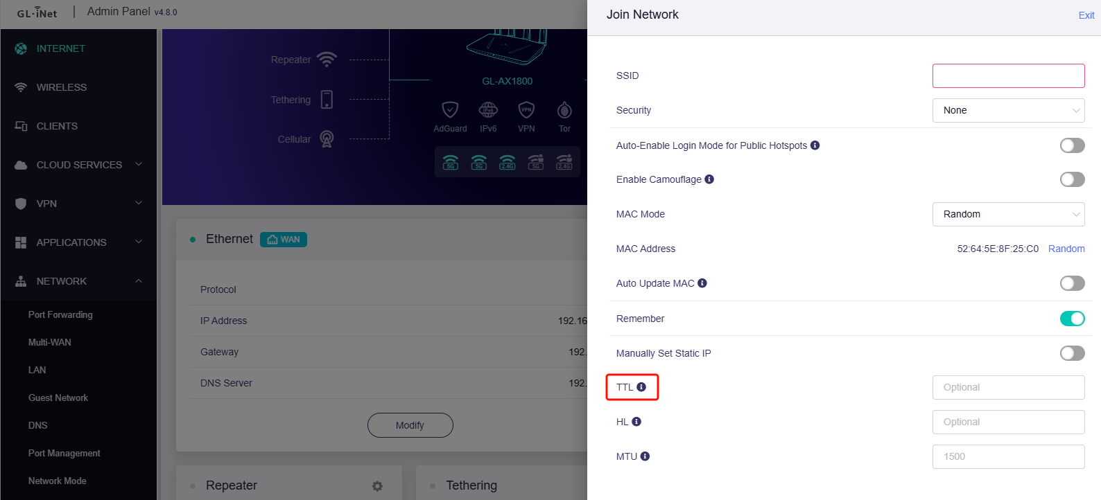

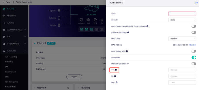

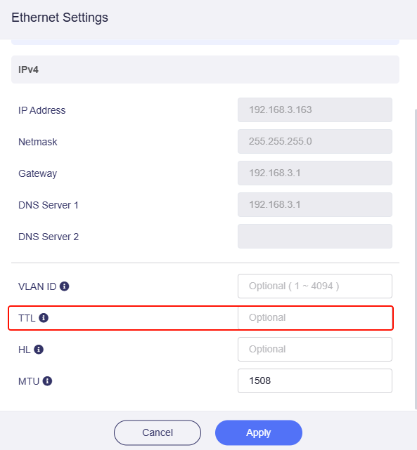

For outbound TTL, it can be set in the GL GUI, without SSH.
thank you, where can I find the setting for wifi?
I looked in my flint and didnt even find the ethernet setting from the screenshot but am not connected to ethernet also....
asking because I "might" get into the situation where the hotel wifi refuses connection.

Please upgrade to v4.8.0 firmware for Flint, and find it in:
