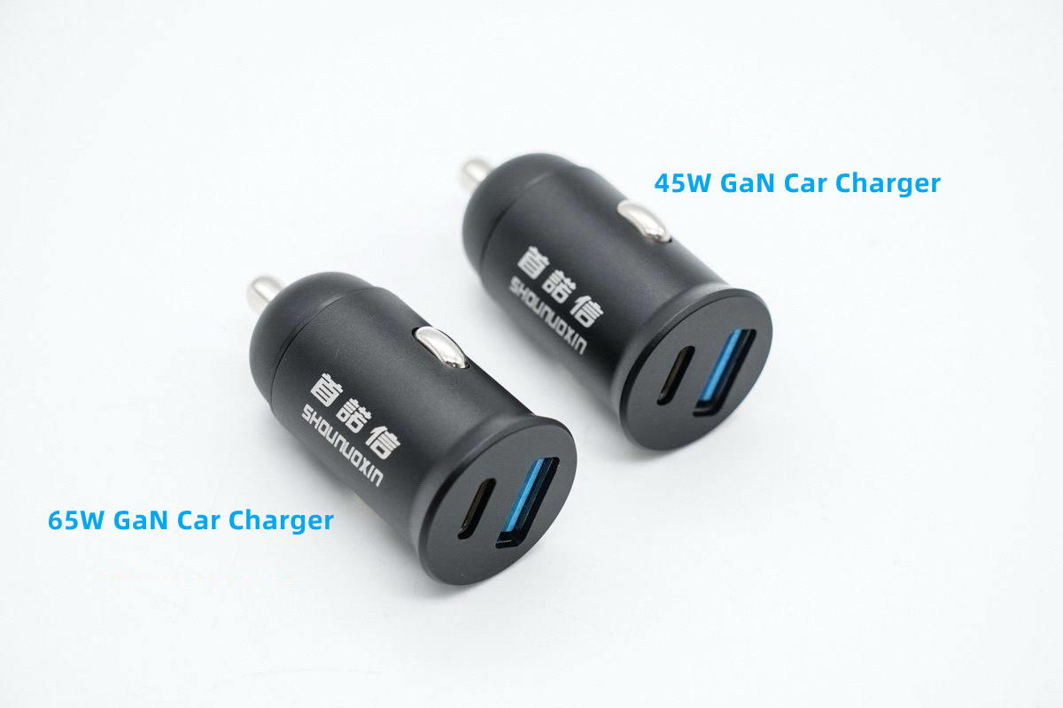

Yes, GaN can increase efficiency, but I have been unable to find any USB GaN power supplies that operate from 12V in the market, and I have been looking, both for this application and for charging other devices like laptops.
I suspect part of the reason is that for 12V operation the supply would need to be a buck-boost converter rather than a simpler buck-only down-converter. And maybe GaN is too new to have filtered through to more niche applications.
One option for the router would be to use USB PD input but add an additional connector to allow direct connection of 12V - it should be easy enough for the internal converter to work from 10V (USB PD) or 12V. I assume you only need 3.3V or less internally so only down conversion is required.
I do however take your point about wider market appeal with USB as a power source, and we are only talking about a marginal difference in efficiency, so it’s not a must-have. SMA antenna connectors would be a much more important feature IMHO.
USB-C PD 3 GaN car chargers exist, below I attach a link to an example of such a review of my favorite website that tests innovative power supplies.
Of the more interesting things, this charger has 65W, is very small and has great energy efficiency. Supports ultra-fast charging with PPS.
Other interesting things are that it can deliver up to 20V from the 14V voltage in the car circuit to the USB-C port using PD.
