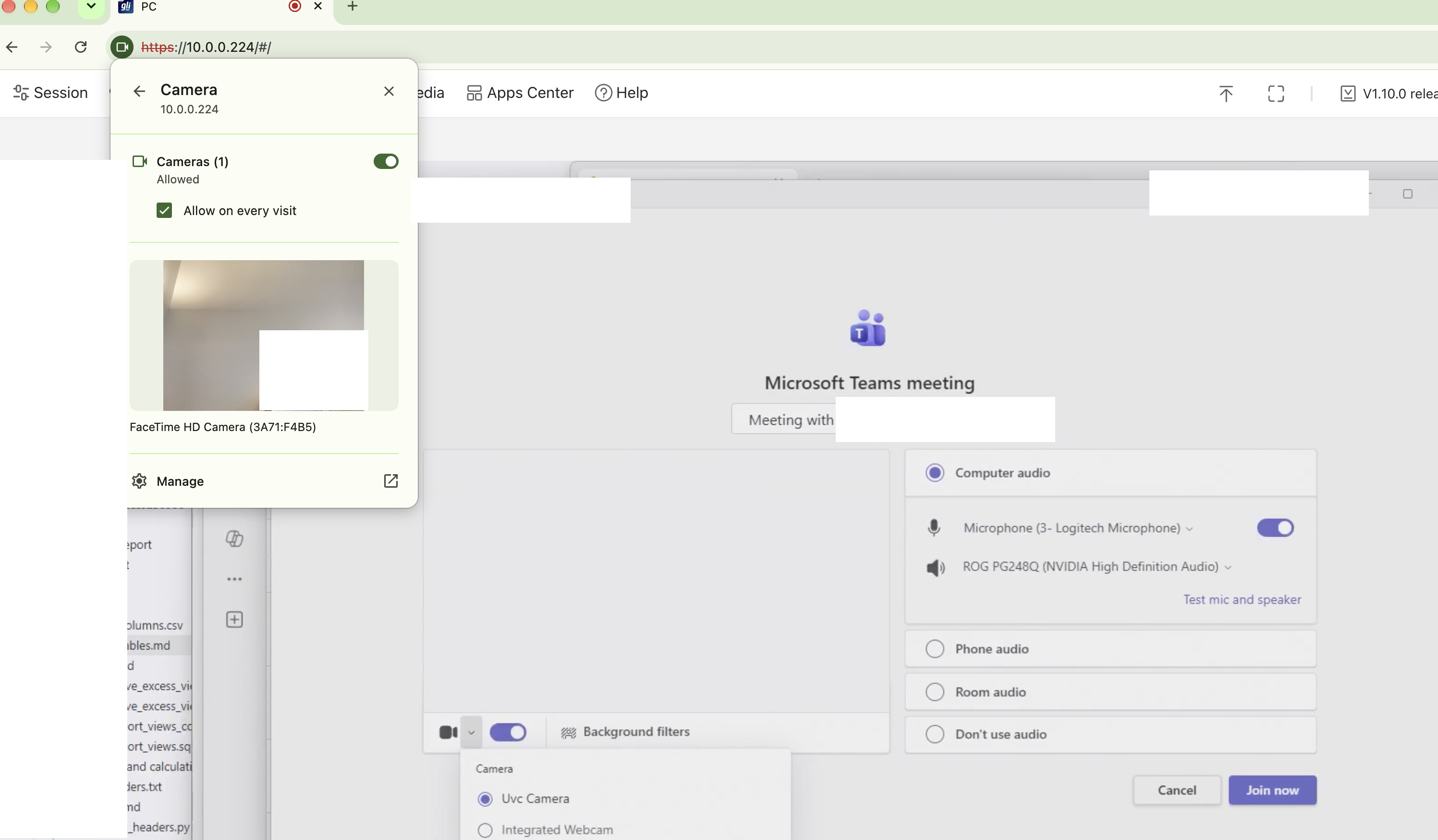

I own a GLiNet COMET pro. and one of them I recently updated the firmware to V1.10.0 release4 which has the Beta camera and microphone. I’m happy to report that I was able to successfully use it! I was a bit surprised when it worked the first attempt! I note that this post is originally from March 17 so maybe this reply is late, but it adds to the record. thanks
