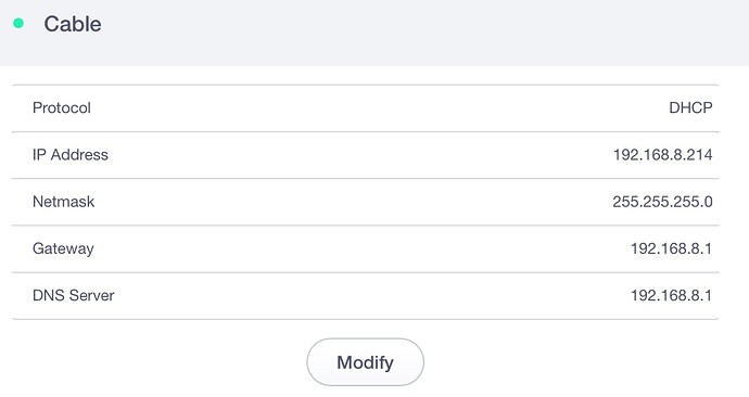

The beryl WAN is connected to the Slate AX with an ethernet cable.
192.168.8.1 is Slate’s IP

Thank you! It works now!. I’m using azirevpn and changed the dns value to the Slate AX ip in the servers configuration.
