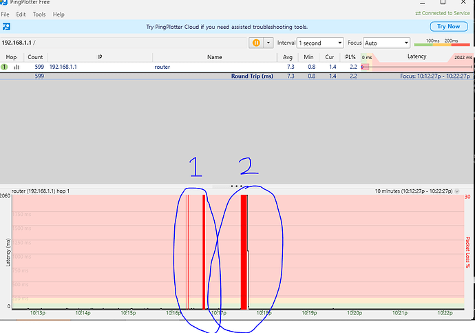

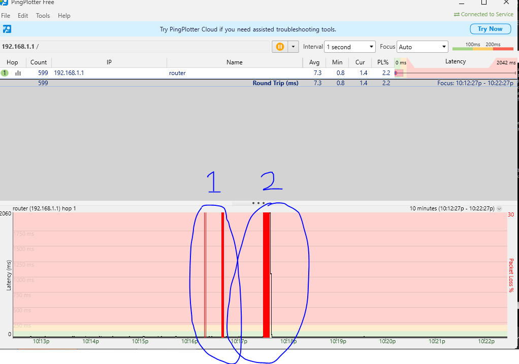

here's an example of what happens.
the first blip was when i simply plugged the USB cable back in with the USB 5G dongle. there was a quick little blip there but quickly recovered. the interface was not activated or anything.
the second blip is when i went to the UI and for eth2 (this USB dongle) i clicked "connect"
note that this ping is from a hardwired desktop 192.168.1.2 to the router 192.168.1.1 - there is unmanaged switch in between but i've never had an internal LAN network die off like this when a WAN issue (or something else...) is occurring.
