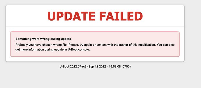

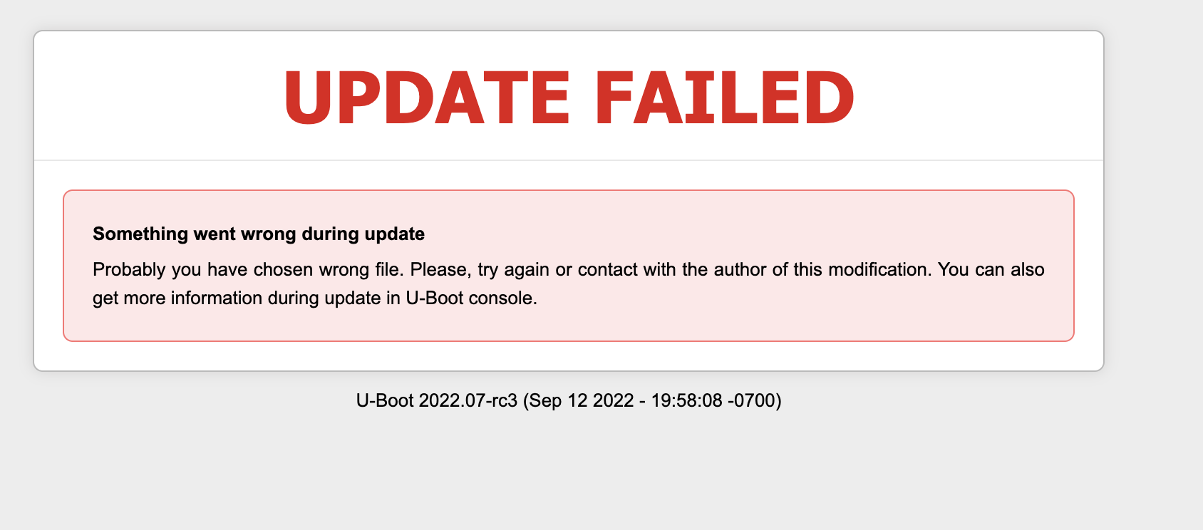

I have a GL-MT2500A. It just stopped working. There is no accessible interface apart from U-Boot. I cannot flash/update U-Boot nor firmware, always the same message:
I tried Chrome and Safari on Mac. No difference. In touch with support, waiting for a solution.
To update/flash uboot, please visit http://192.168.1.1/uboot.html
To update/flash the firmware in uboot, please visit http://192.168.1.1
Yes, I know both links. The error message I am getting is after I try to update/flash either of:
Firmware: openwrt-mt2500-4.7.4-0328-1743128340.bin
or
U-Boot: uboot-mt2500-20250224-md5-74286e770cfb041b611d80d4adaef189.bin
The files are getting uploaded to the corresponding links, but after pressing install, the above error message appears. - Update failed.
