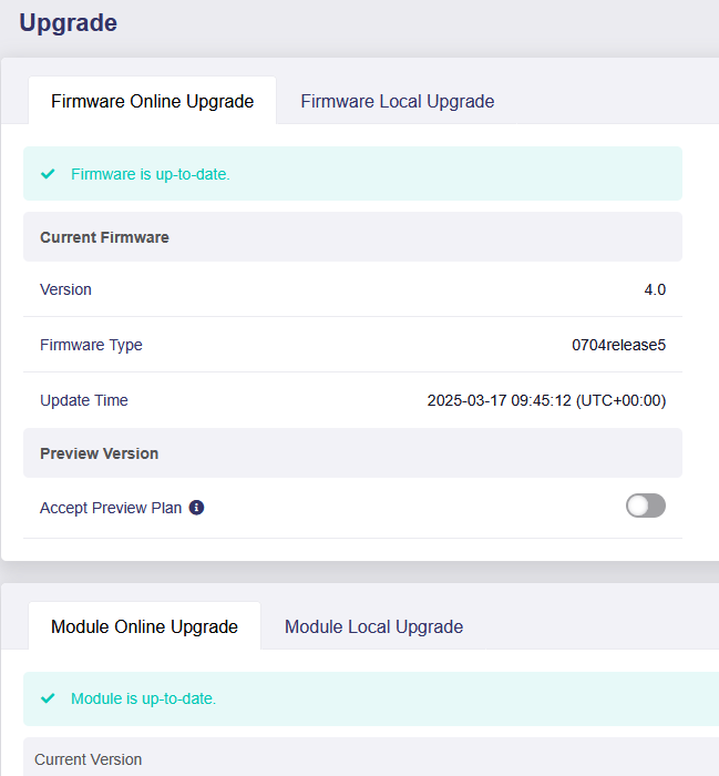

However having upgraded the firmware using the "online update" method, its not clear to me if I have the latest 4.7.4 firmware. Why isn't the firmware version printed in the same way that it is being referred to in documentation?
Should I read this as being:
Major version: 4
Sub version: .07.04 r5
Being 4.7.4 r5 when all combined?
That is correct. It sounds like your problem was your wireless only laptop, not a wireless router lol.
