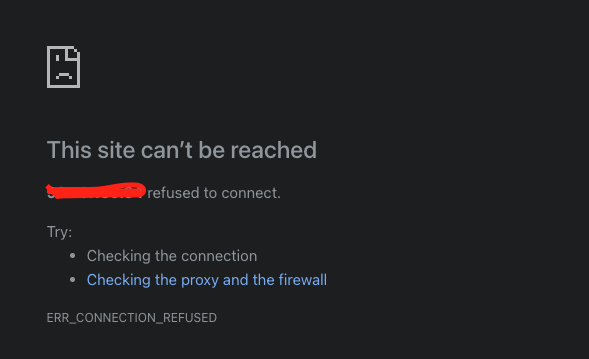

GL-iNet DDNS test shows that the WAN IP is properly being resolved, but upon trying to visit the domain name, I am getting an error stating xxxxxxx.glddns.com refused to connect (ERR_CONNECTION_REFUSED).

Screenshot 2023-12-27 at 7.45.27 AM

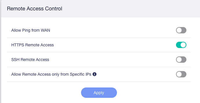

This is the error that I get. I have remote access via HTTPS enabled in the Security settings. I don’t have ping from WAN on, so maybe that’s why I can’t use the WAN in the address bar, but the domain itself doesn’t work even though the DNS is being resolved according to dnslookup.

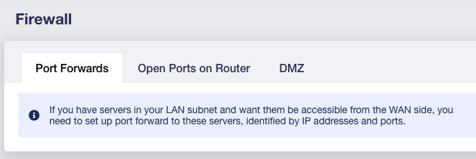

Should I use the Port Forwards tab or the Open Ports on Router tab? This particular area is within the GL-iNet software, not luci:
You can, but the GL GUI does not support ranges. So you have to enter all ports one by one.
Luci does not have this restriction.
But for those approx 10 ports it should be OK with GL GUI. And Port Forward.
