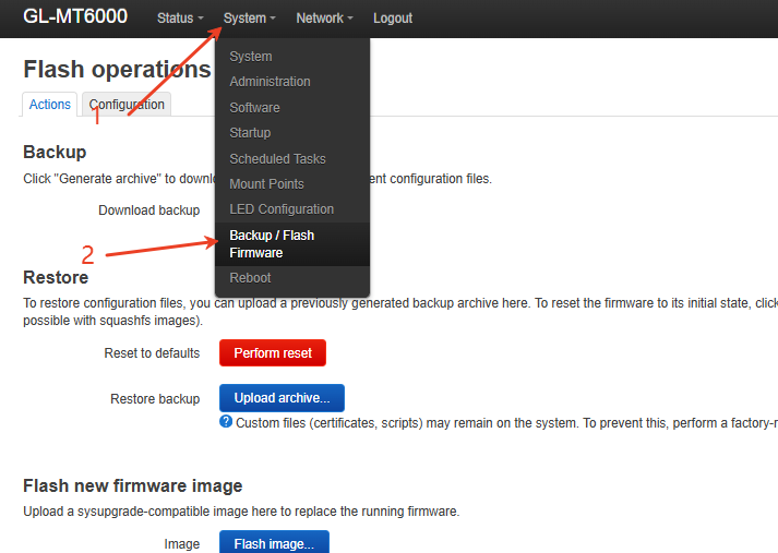

You can check which files are included in the LuCI.
In LuCI, go to System → Backup / Flash Firmware:

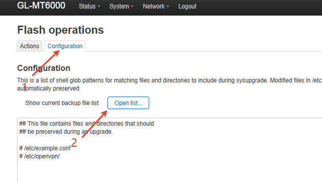

Under Configuration, click Open list... and confirm that /etc/AdGuardHome/config.yaml is included.

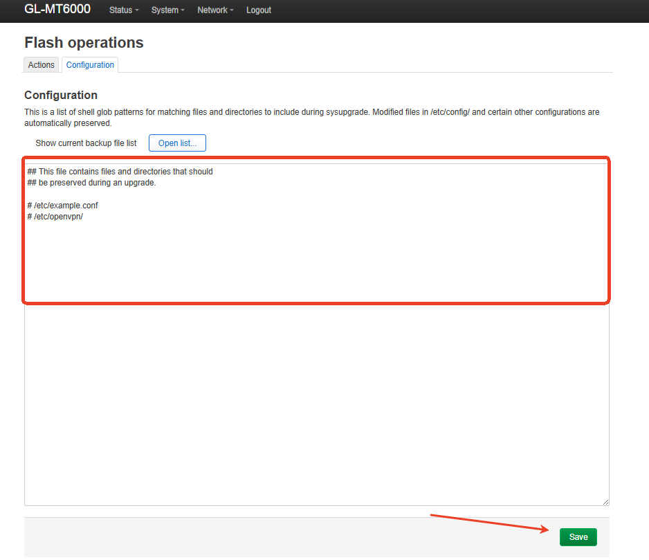

If you would like to include any additional files or directories, add their full paths to the list, one path per line, and then click Save.
