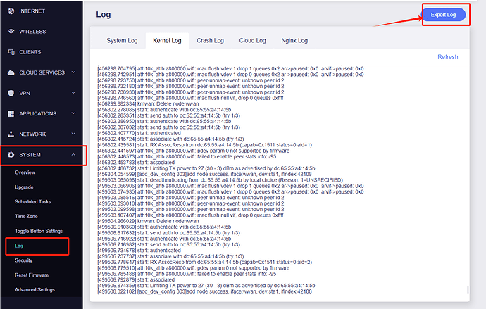

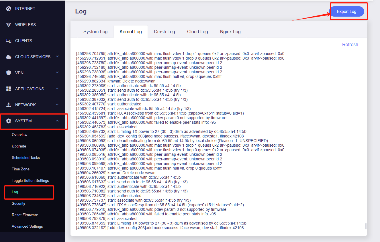

Sure, please try to reproduce the problem and export the log after the router is working properly.
If possible, could you provide us with a remote debugging environment on your computer?
