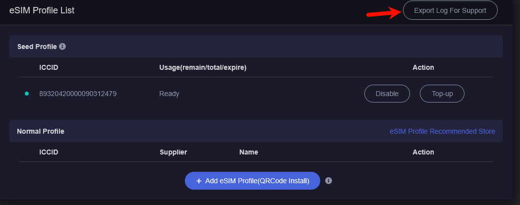

What issue did you encounter about eSIM?
The physical eSIM from GL.iNnet does not PIN lock by default.
If the eSIM manangement menu missing, please try to upgrade the latest firmware v4.3.26 first.
If the eSIM profile cannot be load, please share the eSIM log with us
