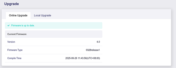

This menu has just completely disappeared. I’m on 0326release1.
I’ve tried resetting the firmware but the menu option isn’t there. Any ideas on what I can do to get it back? Using the EIOT SIM card from your store. Need to change the eSIM profile quite urgently and can’t do it any longer :frowning:

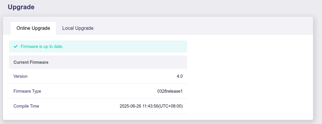

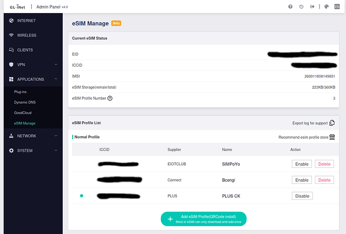

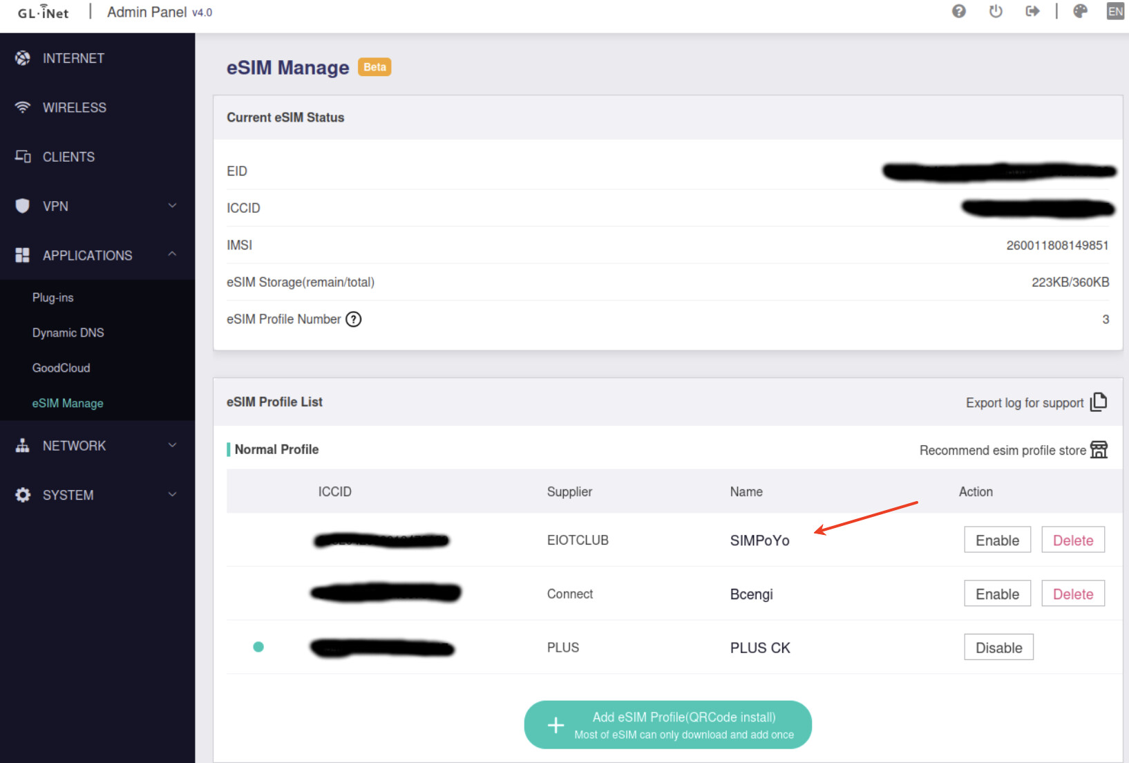

I’ve installed Mudi v2 to v4.8.3 firmware but still I my SIMPoYo eSIM is not seen as seed profile. In stable version (4.3.26) there was no Seed Profile entry at all. Any ideas how to fix it?
I’ve installed stable 4.3.26 version but still I can’t see “Seed profiles” section and my eSIM EIOTCLUB cars is listed as Standard profile
Hi, sorry this is a known issue. The first profile is the seed profile. Please update the Mudi to v4.8 and edit this profile where the supplier is EIOTCLUB. Try changing the name to "seed" and refresh the page.
This issue will be fixed in the future update.
