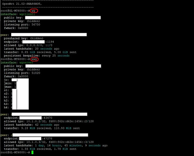

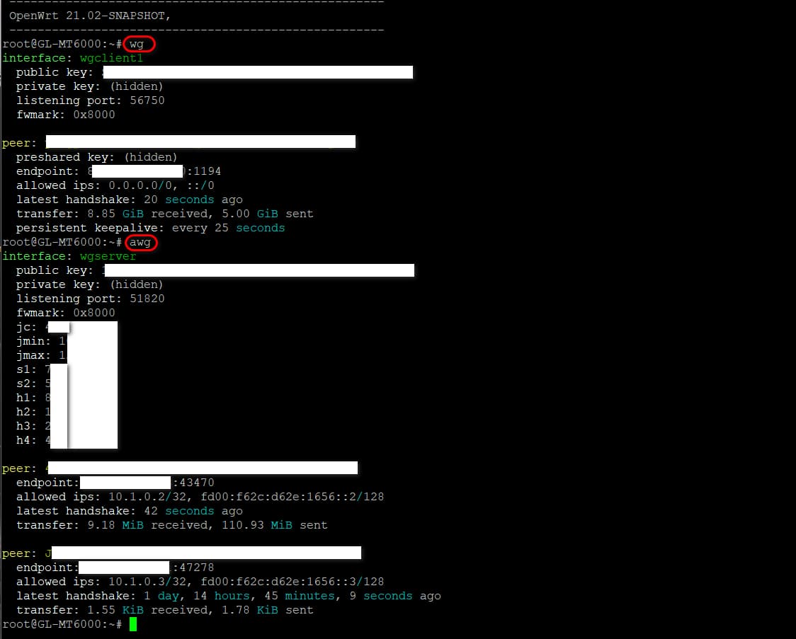

If the WireGuard interface is an AmneziaWG (obfuscated) tunnel, SSH to router and command awg —display something profile info; command wg —there will noting display.
If the WireGuard interface is a standard WireGuard tunnel, SSH to router and command wg —display something profile info; awg —there will noting display.

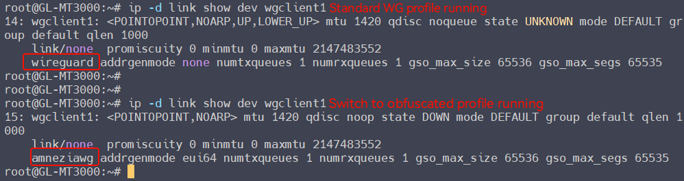

Another way:
ip -d link show dev wgclient1
This will tell you whether your tunnel is using obfuscation or standard protocol.

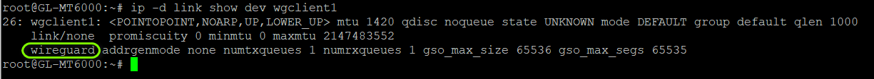

Many thanks @bruce for the detailed instruction. I have followed these steps but still unsure if the connection is using obfuscation or not. Here are screenshots of the output I got for your to kindly check. Many thanks again for your work on this.
