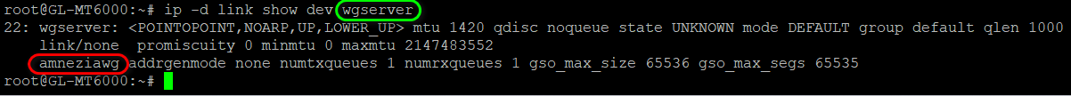

It seems that your MT6000 is running both WG server and client.
According to the screenshot you attached, the MT6000 server is using the obfuscated protocol and the client is using the standard protocol.
Like other models, this feature will be supported on v4.9 firmware.
Makes a lot of sense. Turning WG client off and it seems like it is outputing as expected although I have had to change the command line on the MT6000 replacing “wgclient1” by “wgserver” instead:
I suspect that this means all is working well and as expected. Keep up the good work and many thanks again.
