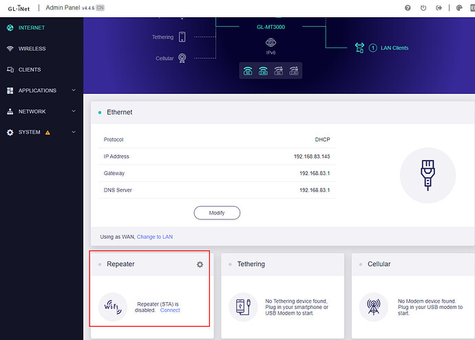

Installed on both mt3000 and axt1800. Allows Mt3000 to connect to axt1800 as repeater at 5ghz, which is rare. I notice this beta firmware is now unavailable.
Do you mean MT3000 failed to connect to AXT1800 as repeater(feature shown below) at 5G after v4.4.6 beta1 was installed on both MT3000 and AXT1800?Which channel and bandwidth are both devices working in at 5G?Could you post me the logs?Thanks!
No. The mt3000 connects to axt1800 as repeater without fail. It is an unusual feature that the connection is always 5Ghz. Using past firmwares, the connection is usually 2.4Ghz.
Repeater mode selects band to connect to based on signal strength and 5G priority;You can select 2.4GHz at “Repeater → repater option → Band selection” if you want to connect at 2.4GHz only.

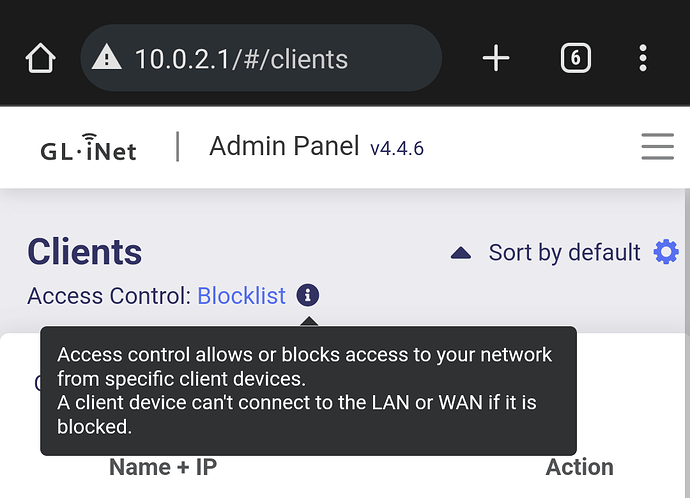

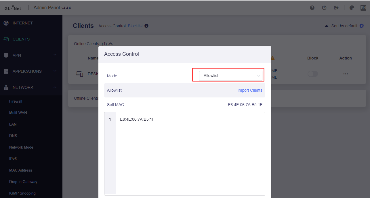

can there be an option to automatically block devices (quarantine) so they can be added to the access control list? And maybe a webui to view blocked devices and notification via goodcloud that a new device was quarantine. This could come in handy for them kids that try to connect with private MAC.
I guess I shouldn’t have bothered mentioning it. It was missing, but now it’s back.
