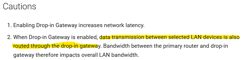

Hi!
It sounds good. I think the ‘gateway for specific devices’ would make sense. Is it possible to disable the DHCP service on the MT2500? I´d prefer to use DHCP on the ISP router.
And there´s one statement in your docu which I don´t understand:
Why is it neccessary to route all traffic in the same subnet over the drop in gateway? The standard gateway only has to route packets to outside the local subnet. Maybe I do not understand complete how the drop in gateway works.
Hmm I think what they mean is:
Without drop in gateway the normal behaviour is your main router answering to be the main gateway as reply, this happen when a client i.e your pc asks as packet communication.
When drop in gateway has been enabled, it spams the awnser reply, meaning... it responds faster than the normal gateway in where the client gets confused into thinking the drop in gateway is the one.
In my opinion it is kinda exploitive but yea :face_savoring_food:, so with this kind of nature it is expected it goes route over this gateway there is not really much to control I would think.
Also it happens on ARP which is layer 2 by the osi model, I believe at this layer ips do not exist, this is probably also a reason, ARP is the protocol which translates a ip to a unknown mac address, meaning that everytime a device connects to a ip it uses arp to question whos mac address it is, so if the ip was the gateway the drop in response would be faster in a spammy/forced way replacing the mac, lan clients also see these replies and fall for the same pattern...
Well, I’ve tested it today. It works very good, and there´s no kind of exploid with the ARP protocol. I can see a correct ARP table on my PC. I think there´s no technical problem, the only problem is the docu. :grin:
